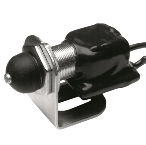

    Hey. This the brake light switch in my '32. Simple, two wire switch. Not much to go bad, but I need to replace it about once per year. Tail lights have two bulbs, one bright, and turn signals and hazards still function. Is there something that could be causing this to fail so often? Thank you for any advice. 20210521_140312.jpeg

    Those hydraulic things have been fizzing out for decades. Change to a lever switch style.

    I have heard that you can purchase better quality ones from Harley Davidson dealers.

    I've ran that switch on several cars including the coupe I just finished and they are a problem. The old switches would last for years but the newer ones are basically junk, my 60 T-Bird used the same style switch and they usually lasted a couple of years.

    Or replace with a Harley D item. Mine has been working satisfactorily for years now. The beauty of this is save for the need to swap out the electrical terminals ( hardly a great chore) its a like for like swap / fix.

    Okay, just went through this with my friend's '38 Willys PU. Other friends never have an issue. The only difference is that his switch is mounted down ( contacts on the bottom). Others talked to have theirs mounted up. Is it possible that fluid leaks into contacts somehow? Don't know, just spitballin' here.

    Mine is straight up, but thank you.

    When I first got my 57 many years ago, I went through a couple of brake light switches. They would last about a year. I stopped at a Mustang parts store and they were touting improved brake light switches. That was bout 20 years ago and it is still working. I'm pretty sure it was Mustang of Chicago. https://www.mustangofchicago.com/

    Lever switch broke and this was it's replacement. Maybe need to rethink that.

    The theme I'm seeing is that these switches are ****. Thank you all. I appreciate your time and experience. (A mechanic I'm not).

    If the contacts are up, then water could get into the switch area and contaminate the contacts. If they're down, it would less likely to collect in the switch.
    The brake fluid is under quite a lot of pressure, when you push the brake pedal. I doubt the tiny tug of gravity would make it leak...

    Maybe not your need but i use a RF brake switch... on all my cars and never a failure.

    72023-51 is a Harley switch number. There may be a superseded number but this will work.

    The best thing to do with That style switch to throw it away. The second best thing to do is mounted in a place where are you can change it without losing any brake fluid. Consider it a consumable item when you change your fuel filter change your brake light switch

    I have 72023-1 for the Harley switch? It's a low pressure switch that's supposed to be good with DOT5?

    Member 100% Matt sells a brake switch that has the brake fluid separated from the switch so switch can be replaced if needed without opening up the fluid circuit. You can contact him for more info. He is in CT and sells them through Millworks in MA.

    Got rid of my in line stock switch about twenty years ago when it would only come on when I was at a dead stop and was almost rear ended. Made a bracket and put a mid eighties Chevette electric switch and been working perfect ever since.

    The Harley guys seem to recommend Accel #181101

    I used the HD switch in my 34, been working fine for 3 years. But I used a lever style switch on the PU I am building because of these posts.
