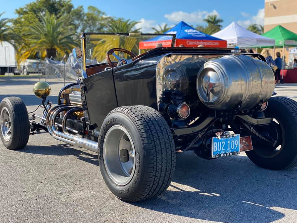

    gimpyshotrods
    I would tuck another red lamp on that, hidden ahead of the tank, facing the shiny rear panel.
    Light the whole thing up when stopping!

    I have posted this before but this started out as a joke. I left it. I have had comments about how visible it is...I HOPE SO !. Still, it won't have any effect on those not paying attention, but get those on the fringe.

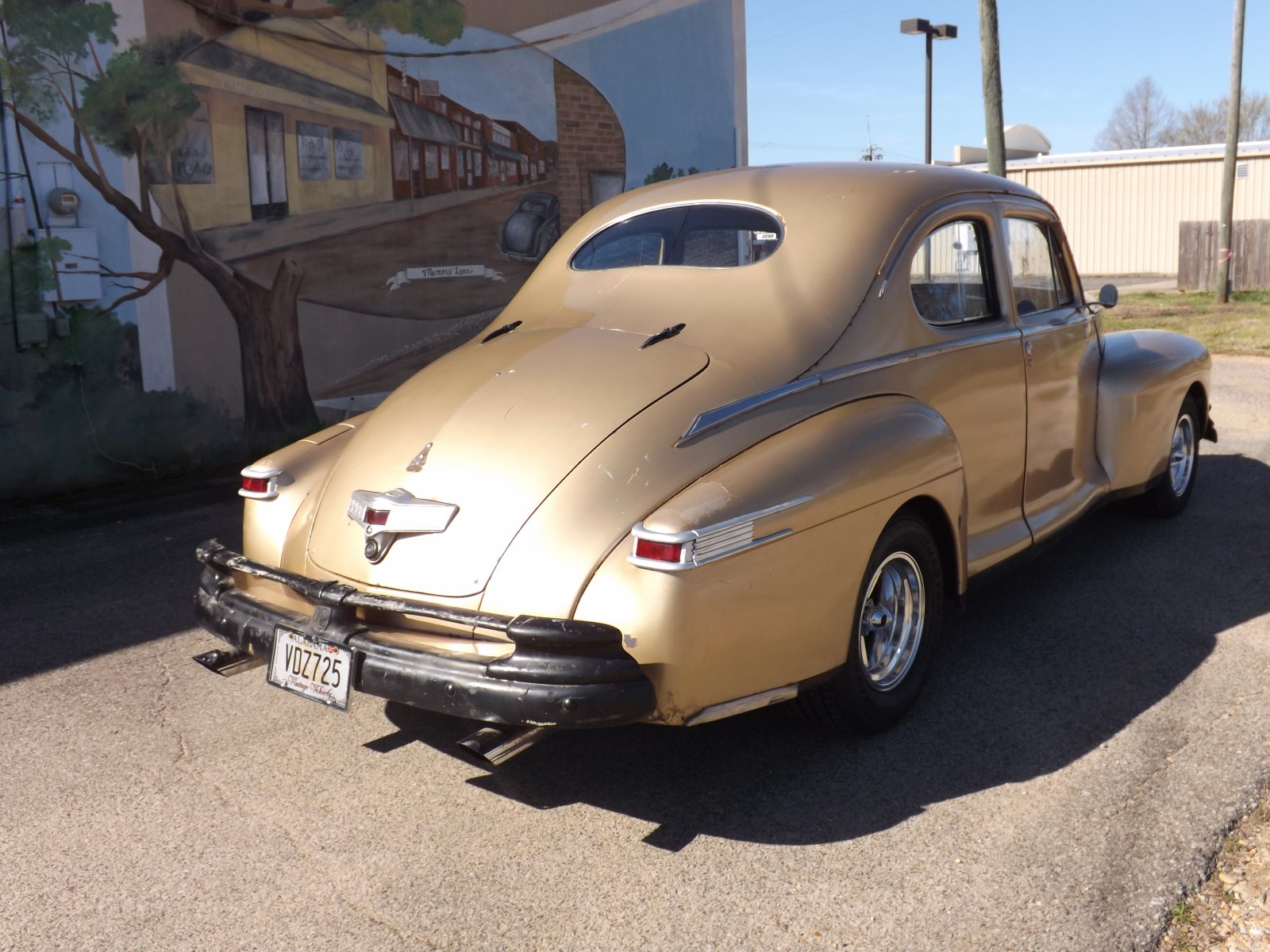

  11. HOTRODPRIMER
    Joined: Jan 3, 2003
    Posts: 64,759
    HOTRODPRIMER
    The car has been black for 80 years, so I'm gonna live with that. :D HRP

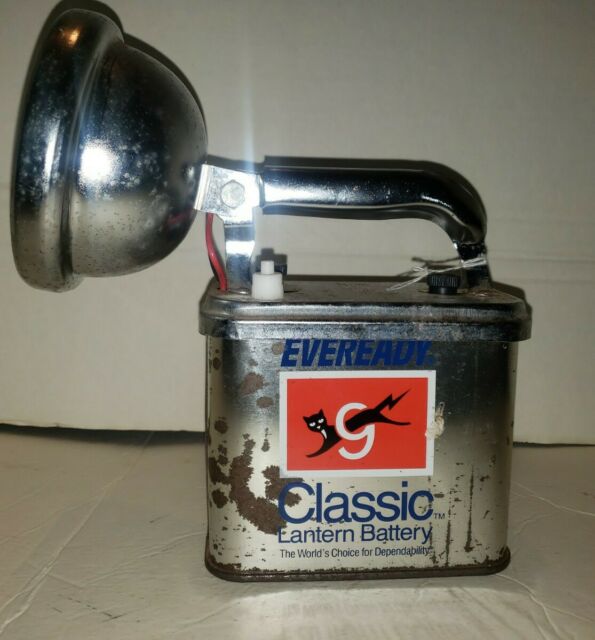

  27. We do have one of those, but thats a 40s era isnt it?
    This is the light in question, its a Rheostat equipped one.
    Oh, reminder that 1957 was 65 years ago.
