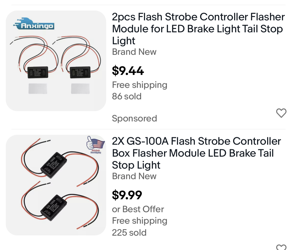

    A flashing light draws attention. I have heard of an inexpensive kit to retrofit taillights to flash in a sequence. This simple change doesn’t change the look of the car. Every should do something like this for safety. The one I was thinking about was for motorcycles, but I don’t think that makes a difference. Somebody please look that up. I haven’t yet had my coffee this morning. Ha, ha.

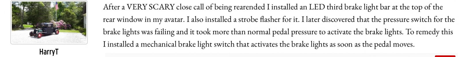

    After a VERY SCARY close call of being rearended I installed an LED third brake light bar at the top of the rear window in my avatar. I also installed a strobe flasher for it. I later discovered that the pressure switch for the brake lights was failing and it took more than normal pedal pressure to activate the brake lights. To remedy this I installed a mechanical brake light switch that activates the brake lights as soon as the pedal moves.

    Actually I was going to suggest that anyone adding a 3rd brake lite wire it in some manner that application of the brakes caused it to flash. While nothing will guarantee that someone will see you, I think something flashing is more likely to catch their attention.
