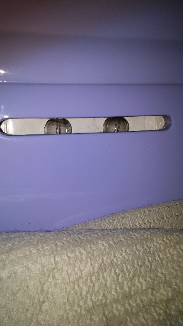

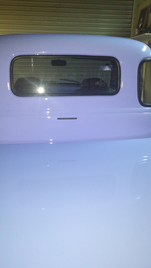

  2. I added a third brake light. Took it from a Dodge Neon (wreckers) if I remember correctly. Cut a slit in the body and flush mounted it like on the Neon. I felt better knowing it was there and no, I was never hit.

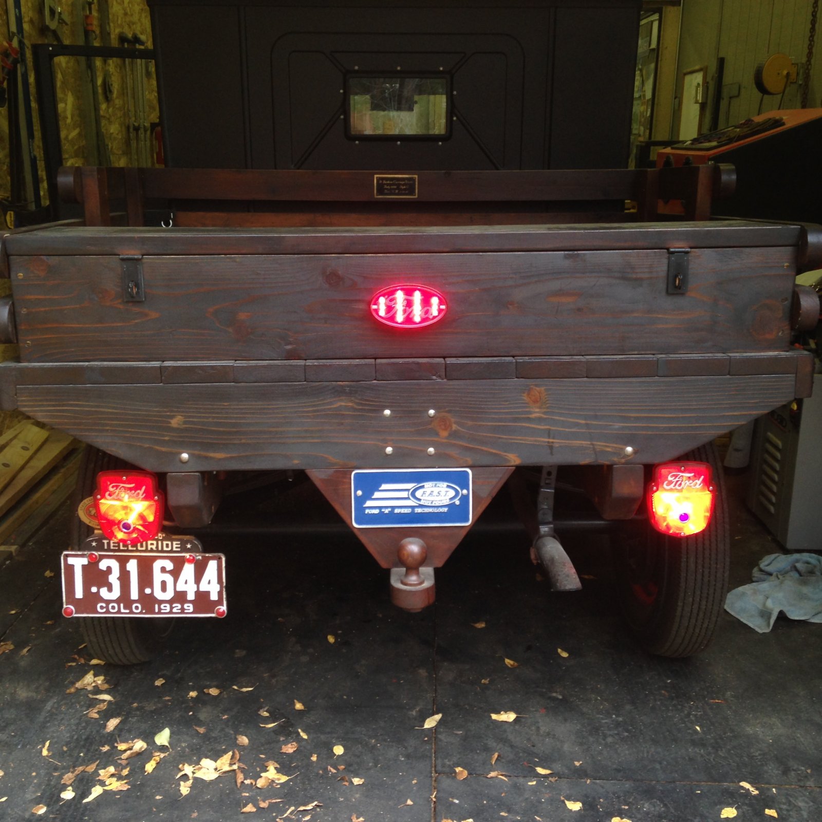

    LED ‘56 Ford truck lights and third brake light is one used in a hitch receiver. Note the blue dots

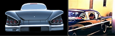

    In talking with other hot rod guys, the 1958 Impala was a great example of a custom approach to the third brake light. The rear roof top vent had the perfect arrangement and height for a third brake light. Our 6 red brake light customization was good for the times. All 6 lit up with the touch of the brake pedal. But for the modern age driving with 100x more traffic and congestion, a third light is a mandatory addition.
    upload_2022-5-16_4-6-1.png 1958 We had 6 same stock red taillights in place.
    It is one of the only designs that comes with a piece that could incorporate small LED lights in the provided spaces.
    Clear frosted lenses would show the car as stock, in the roof vent accessory area. Or some tiny red LED lights are bright enough to light up the whole indentions with only a small bulb hole. it would only be visible during braking.
    We all know that a very popular thing to do was to replace the white center light lens with all red lenses. Then it was re-wired to have all 6 red lights stay on during day/night driving with the standard headlights. Finally, all 6, brighter, red lights came on when the brakes were applied, anytime.
    So, the rear was fairly covered in the dark or while running. Now, with the addition of the custom approach to modifying the roof vent, the height along with the 6 red taillights can warn rear drivers of any braking situation. When stopped for a light, with the pedal pushed, 6 lights and the 6 individual inserts would stay lit. YRMV
