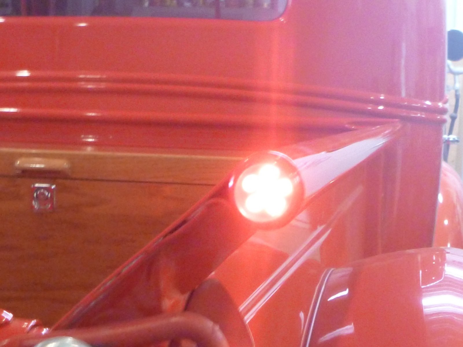

    The photo was taken in broad day light, I'm sure they will show up very well at night. HRP

    When adding LED'S is that just plug and play or some other modification to elctrical system.
  3. David Gersic
    Joined: Feb 15, 2015
    Posts: 2,813
    David Gersic
    from DeKalb, IL
    You may have to change the flasher relay too.
    LOST ANGEL likes this.
  4. gene-koning
    Joined: Oct 28, 2016
    Posts: 5,795
    gene-koning
    My coupe has full turn (front and rear) and brake, and a 12" long 3rd brake light, all LEDS.
    This is my 3rd vehicle with full LED lighting, I've not had a problem with the standard flasher, or any lighting concerns.
    However, I just added an aftermarket cruise control, and the wire that picks up the brake light signal for the cruise didn't have a good enough signal for the cruise to pick up. I needed to add a 5 pin relay for the brake light grounds to make the cruise control happy.
    Sometimes the LED lights don't create enough resistance in the ground side for stuff to function correctly. There are resisters you can add or the pretty simple 5 pin relay, or a grounded 3 wire flasher unit solves the problem.

    As simple as plug and play, there is 2 sockets on each of the replacement LED lights and a plastic tag light piece that replaces the clear gl*** lens.
    No sir, works fine. HRP
