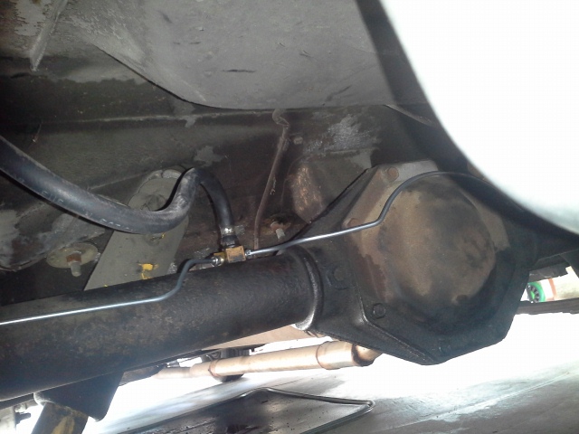

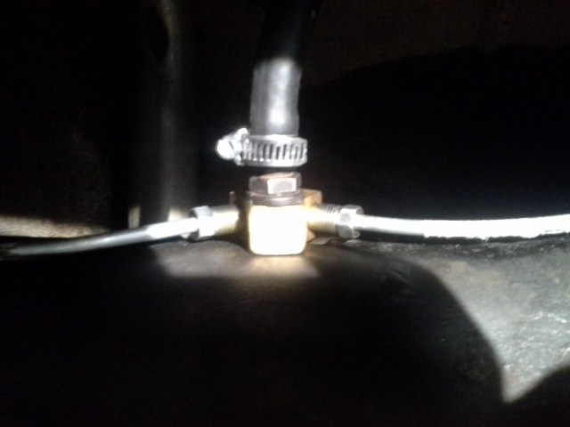

    yes that is the proper way to vent the rear end and Not get water and dirt inside. The hose usually runs up into the frame somewhere, OR makes a 180° turn so the open end is pointing downward.

    Line sleeve's and nuts come in steel for brake lines, been there and done that many times in the past for SS lines and zero leaks.

    Because I walk the walk haha thanks for the heads up! Ran it and made a 180* like hotroddon suggested.

    The skirts are back on and the car is on all four wheels. No more leak/seepage, no rubber hose rubbing anything double check, and rubber vent hose run for axle. Just wanted to thank you guys again! It's nice to know that people can have other people's backs without even knowing them. I hope you see that your advice didn't fall on deaf ears.
