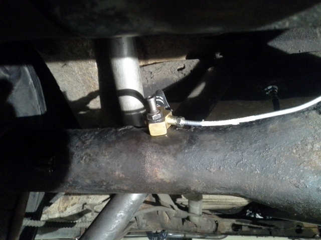

    Bought a 40" line pre made and went on perfect on the rear p***. side. Got a 20" pre made and just need to trim and flare the one side. Great minds think alike :) almost done. Going to take a break and pick up my little one from kinder. Thanks again guys!

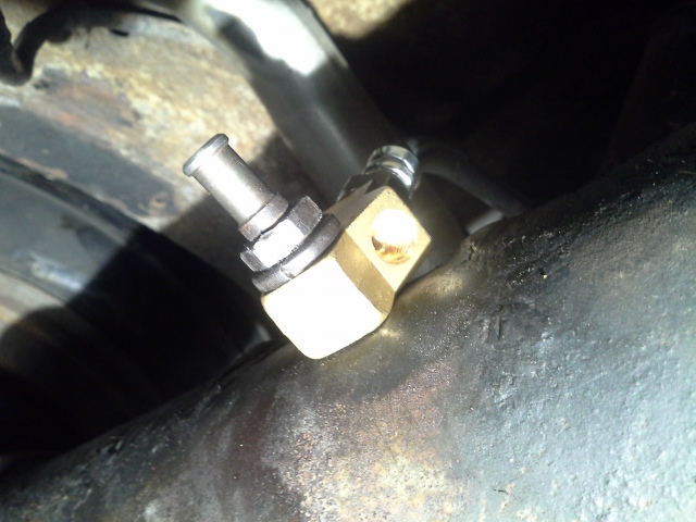

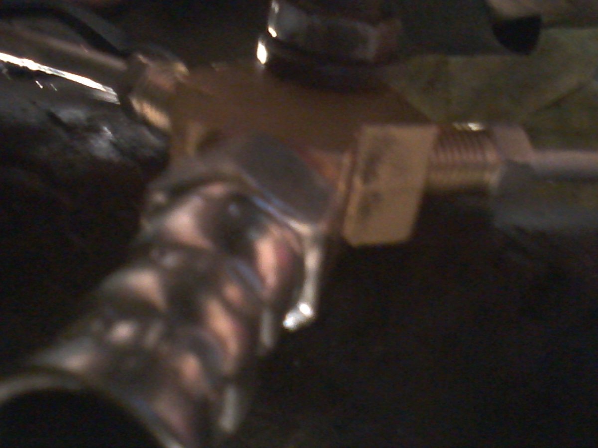

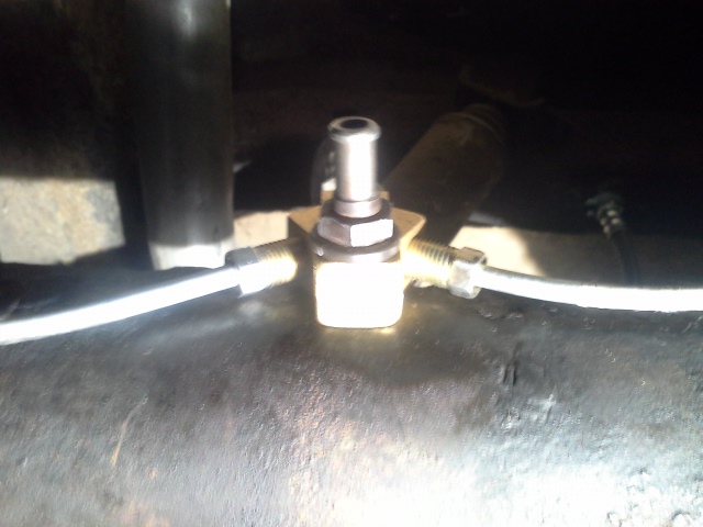

    Today I spent $90 at McMaster Carr for a flare tool and tubbing cutter. I spent 5 hours outside at $95 an hour for $475. I charge for my wheelchair fee $5 each time I have to go up and down onto the floor. 14 times = $70 bucks. I needed the help of my wife to bleed the brake for a 1/2 hour so $47.50 for the hired help. So we have a total of $682.50 for today. Yesterday and today equals a total of $1013.50 smackers! I still have the car up and the skirts off to check for leaks in a while. Crossing my fingers. Thanks to all who opended this thread and decided to chime in. Made this experience easier to handle :) BTW the blue anodized **** is what I took off.

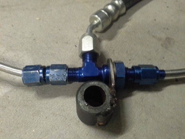

  18. rfraze
    Joined: May 23, 2012
    Posts: 2,009
    rfraze
    The only obvious clue to the leak is on the left side of the T. Something is really wrong there. Looks like tube nut on backwards, then whatever is going on to the left of that. How about taking it apart, so everyone can learn what the problems were. Then you might send a link to this thread to Steve.

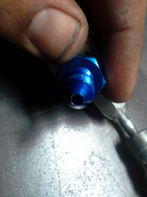

    Went outside to check my work from yesterday. To be honest, I was hoping I would find something. No leaks, moisture, glimmer of wetness, I found nothing at all but a job well done :) when I took apart the AN fittings I found what I ***ume was the problem. It had a slight hairline but also a V rip at the tip of the flare. It must have also grooved the one side. I could feel it with my nail on the blue anodized male part. The other side had no groove as pictured. This could be seen with the naked eye. I used nothing but my 20/20 vision.
    daddio211 likes this.
  20. worn shoes
    Joined: Mar 16, 2007
    Posts: 310
    worn shoes
    That other female nut is from the wheel cylinder. It slid back that's my fault with the pic. But the leak was from the left side. When he used the br*** T it was from the rubber hose and that left side stainless line. That's when Mr. Jb weld was used.
