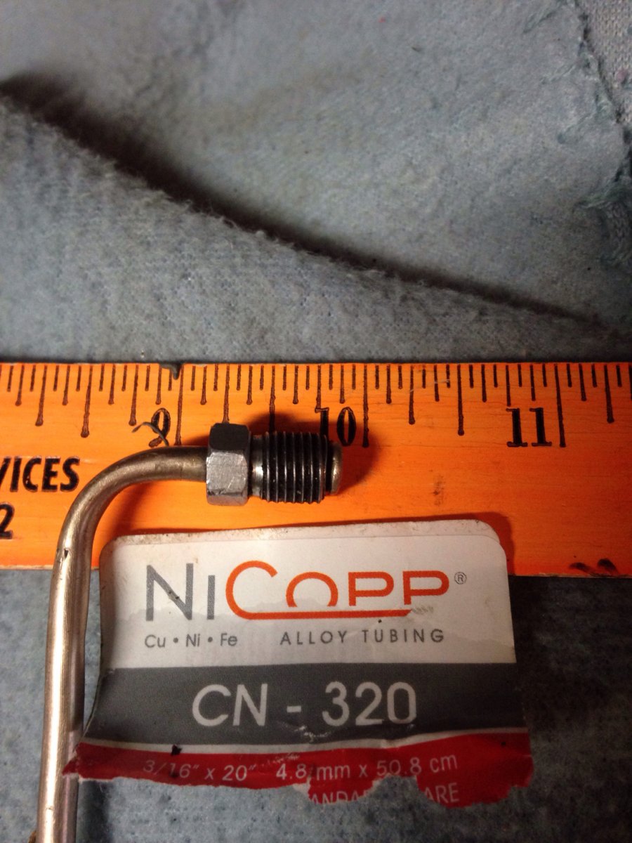

    Looks like basic steel line. Try NiCopp brake line its Nickle/Copper line. You can bend it by hand and straighten it back out if you need to without a bender. For a tight 90 like your looking for here I would use the NiCopp with a 3/8 wrench to hold the nut and a 5/16 deep socket in a vice with nice easy pressure and it will bend right around nicely without kinking. I'm not a salesmen. I get my NiCopp from Advance Auto try it.

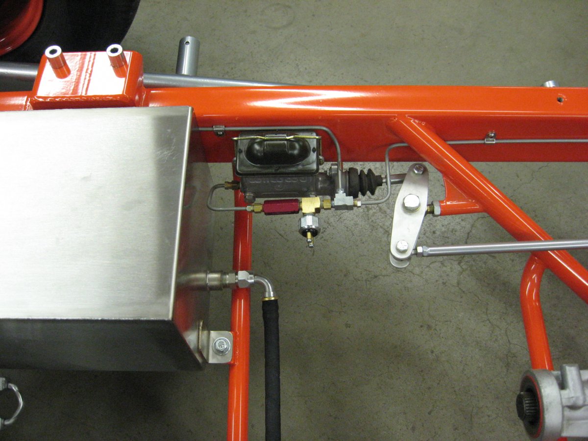

    DRD57 is correct, That style of tool works great for the tight spots. I used one on the line exiting the master cyl on this car. IMG_0685.JPG

  23. ^^^ That ni copp photo above looks like it has flattened the tube to much to my eye. I wouldn't run it.

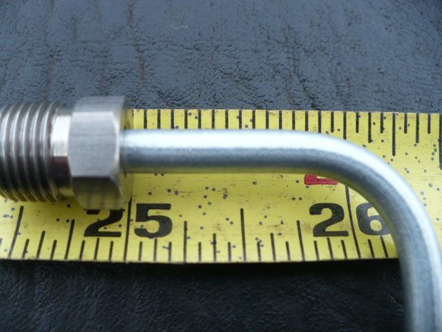

  24. image.jpeg Or use one of these - gets you out of a tight spot, or somewhere where you cant swing a spanner, but can get in with a socket.

    seamus, I don't understand the question. It's a 1" bore.

  30. 28 Ford PU
    Joined: Jan 9, 2015
    Posts: 464
    28 Ford PU
    from Upstate NY
    This was just a s**** piece I didn't run out and buy one to give a perfect example. No matter how you try to help around here there is always someone ready to bash your head in!!!!
