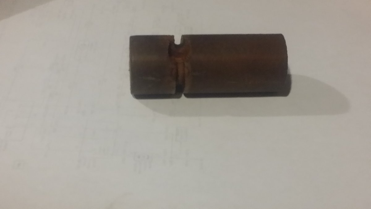

  3. I cut my own slots to the same outside diameter as the pipe I want to bend in a wooden rod of the diameter I want when I am done. I cut a relief for the end so I can put the tube and my brace in a vise, so I can bend to exactly the angle I wish. This gives a real good, clean bend with a tight radius.
    Any round piece of wood, even a tree branch can be used to get the correct radius for the bend.
    If you don't own a lathe, the slots could easily be marked and cut with a saw.
    I have used sand to fill exhaust pipe to make wrinkle free bends, but I have never tried it with brake lines, and I would be worried about getting them clean after the bending. bending jig.jpg bending jig.jpg

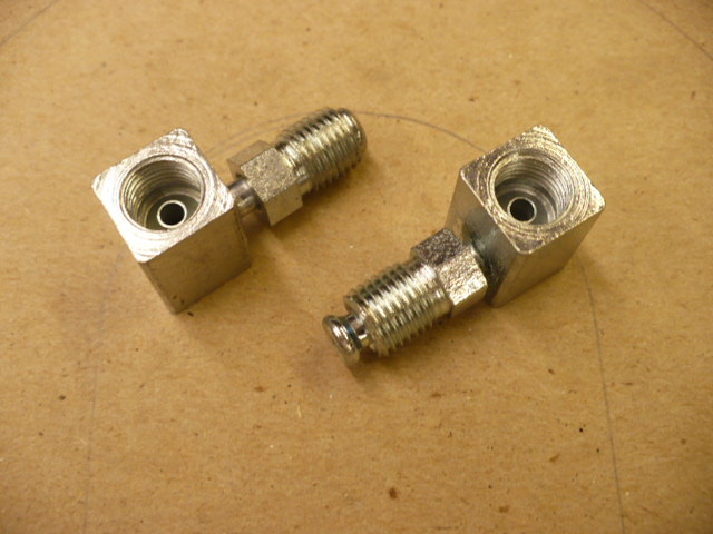

    I have these 90* fittings that I used on my 48 p/u. But they won't help me with what I'm trying to do . These are made by BrakeQuip. I need 7/16 x 24 ,the ones I have are 3/8 x 24. When I bought these I had to order them from a hydraulic hose co. that is about 30 miles from me. To lazy to make the drive x 2. Bill 2017-10-21 20.39.31.jpg

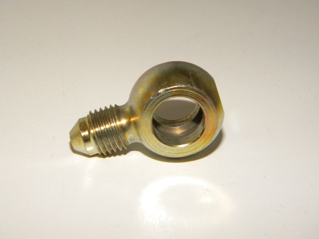

  11. Search for "Banjo brake line fitting" ,they come with a cross drilled bolt, and 2 copper washers.
