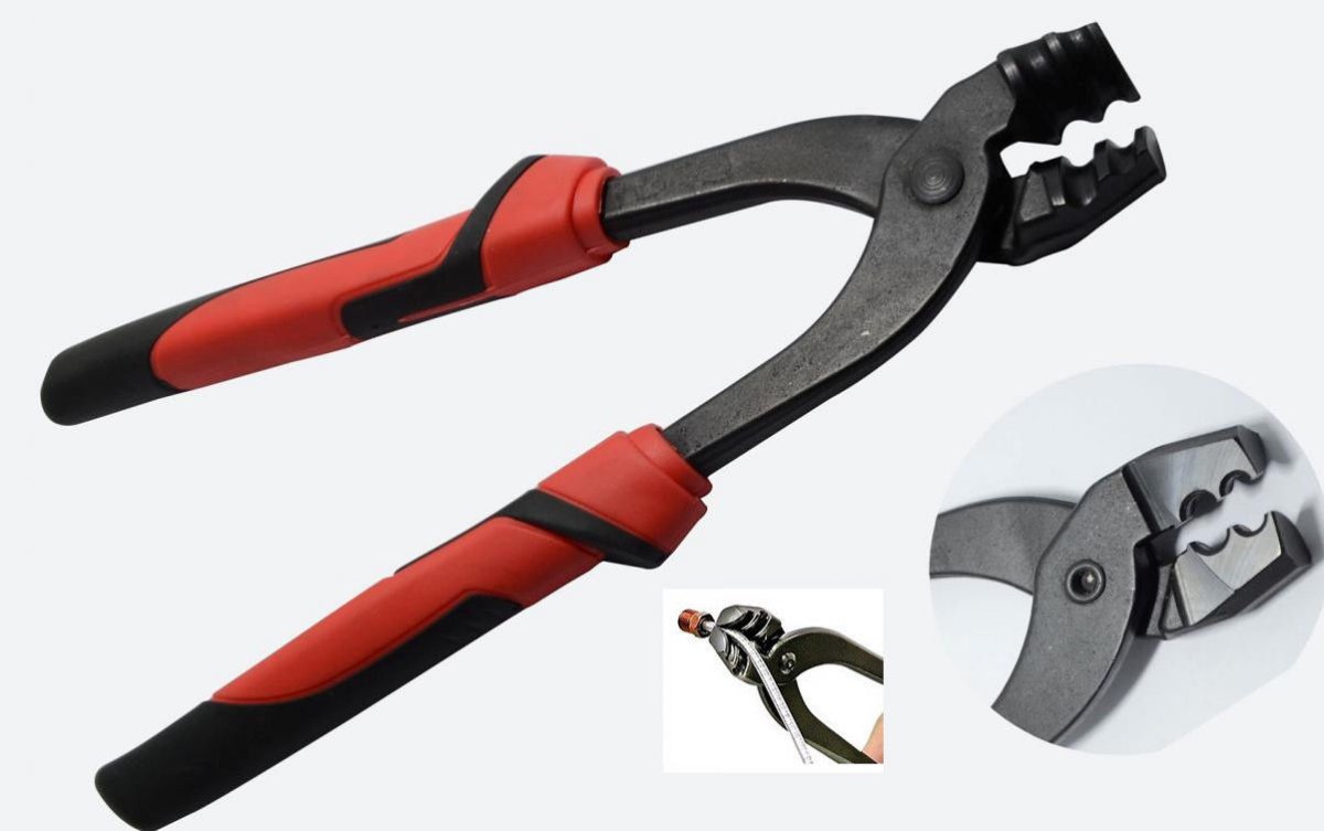

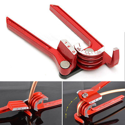

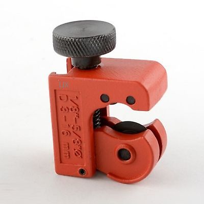

    upload_2017-6-21_8-35-55.jpeg [​IMG] upload_2017-6-21_8-36-49.jpeg upload_2017-6-21_8-37-29.jpeg

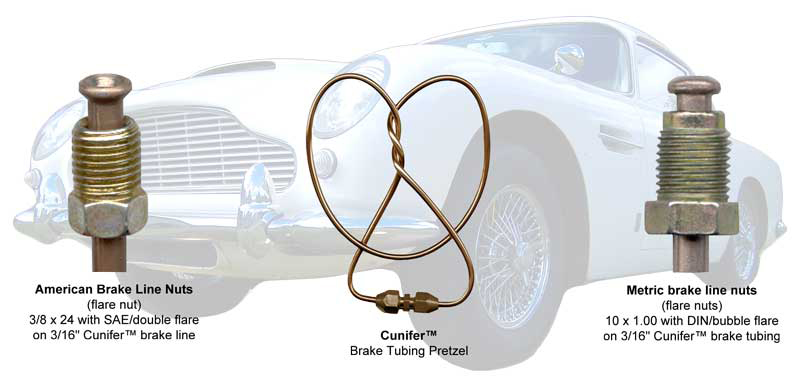

    If I recall correctly, the Dakota uses metric thread fittings.

    Thanks mgtstump - Brisbane hey - Im a sandgroper :) Yes I may need a good tube cutter and bender to be addedto list as well as holdodwns.
    The fitting part is the confusing part I mean ......... for starters like David mentioned SAE or metric ......... thread size ..... and how many different sizes for different lcoations (eg line terminations at actual brakes , MC differnt size) etc

    Thanks - I had read that website - but not that actual article.
    As they mention in the doc for double flare...
    The 3/8 x 24 UNF American nut will thread very easily and loosely into a 10mm x 1.0 thread fitting but will hopefully strip the threads when you tighten it down You can start the 10mm x 1.0 thread nut in a 3/8 x 24 UNF thread fitting but it will immediatly begin stripping the threads
    So guess the way to tell is get one of each ...... and start threading the 10mm to see if it takes or not ... if not then should be 3/8-24
    Not sure about the MC end......
