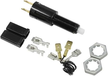

  11. nochop
    Joined: Nov 13, 2005
    Posts: 4,608
    nochop
    from norcal
    Alton Stroope likes this.
