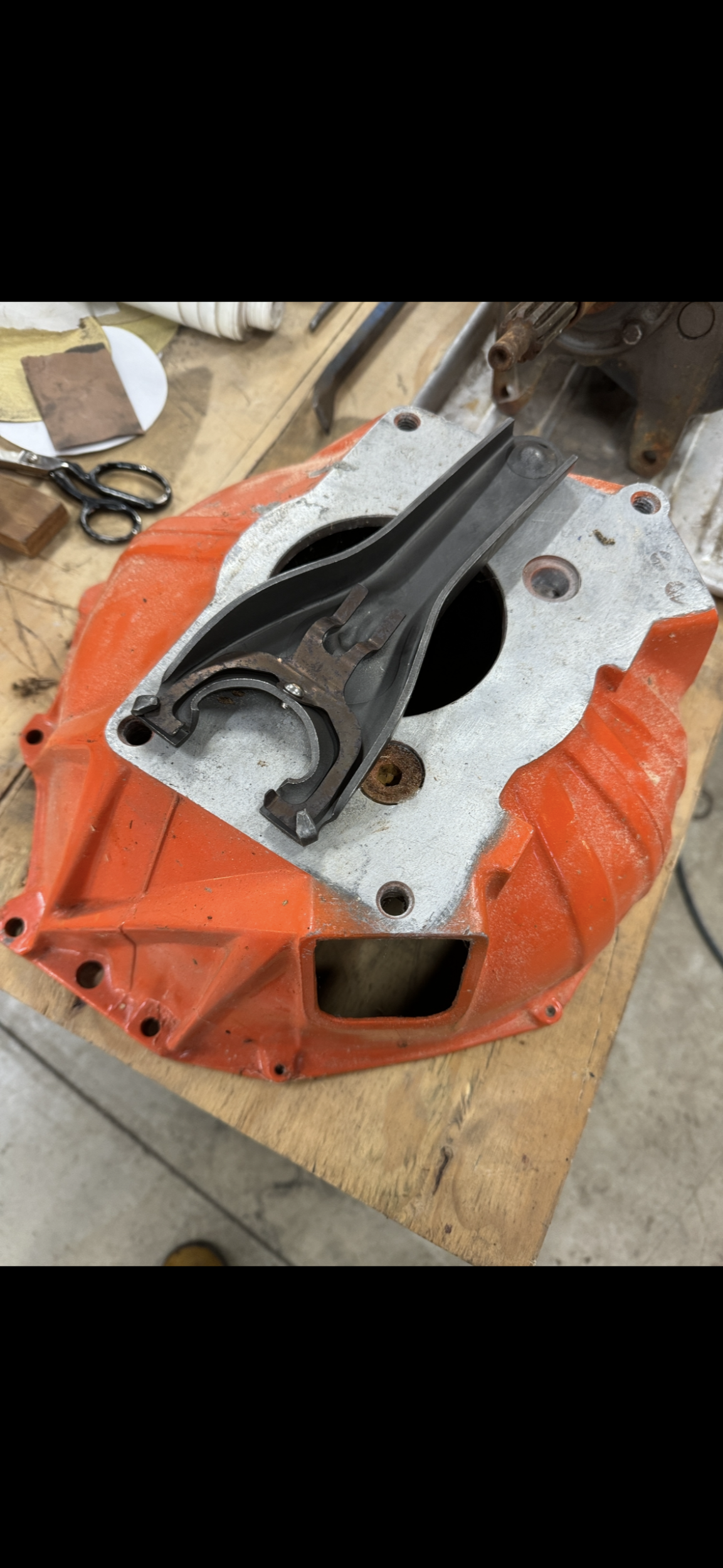

  4. F-head
    Joined: Oct 20, 2007
    Posts: 1,503
    F-head
    IMG_3210.png Here’s a pic of a Nova bell housing
    The fork comes out at 7:30 instead of 9:00
    If you find just the bell you can get a repop fork
    They work perfect with a flipped 39 pedal clutch lever

    Lots of them on eBay are listed wrong, being Camaro or Chevelle
    There’s a couple on there now for under 200$ but I’ve always got em at a swap meet for under a hundie.
    Also lots of times the fork is listed wrong also
    The correct one is in the pic, you just drill the indentation for a pull rod, I use 5/16 bar stock and make a little rounded half ball that’s looks like a mini sbc rocker ball
