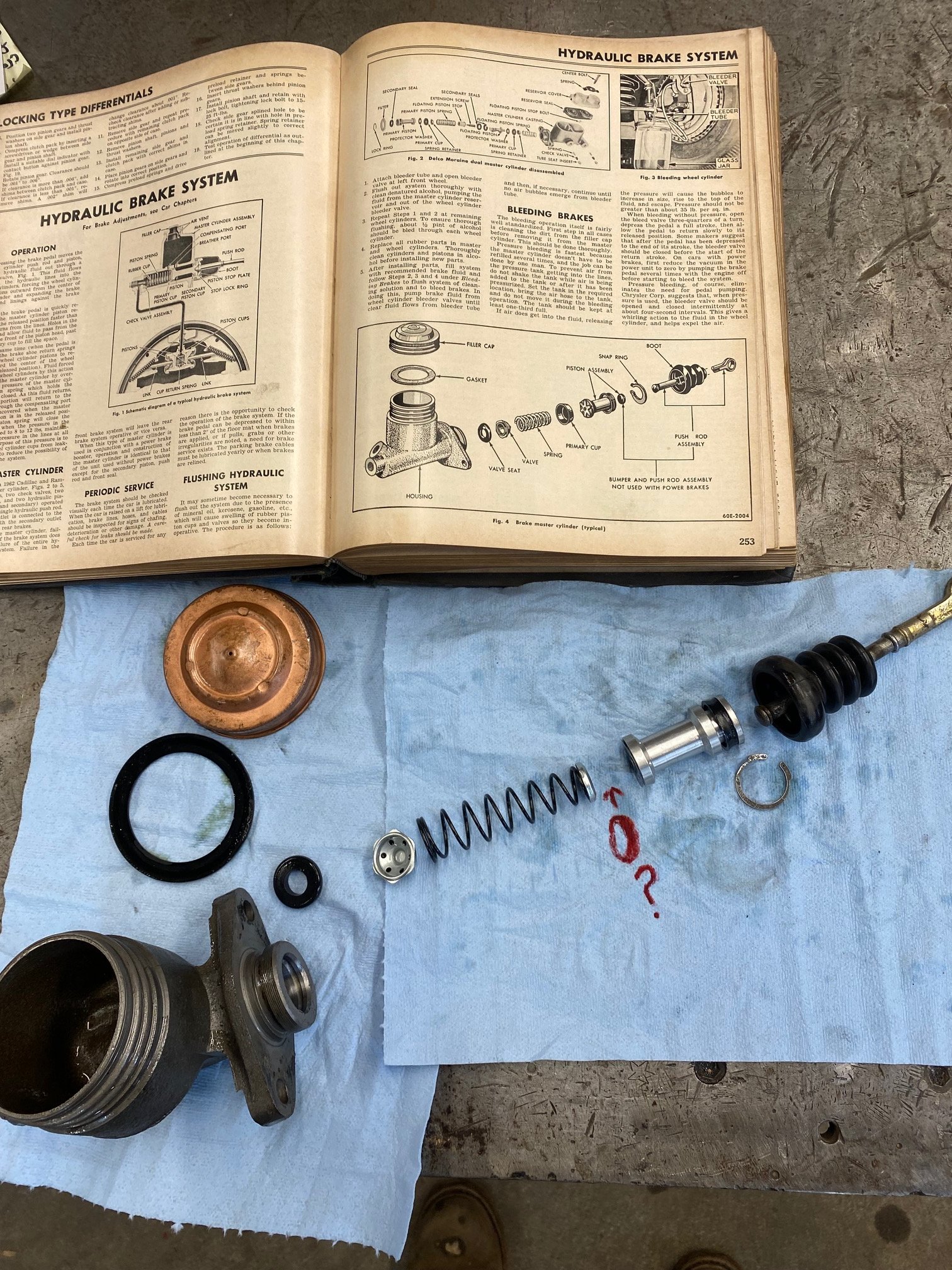

    I bought a brand new master for a project, could not get a pedal. took it all apart and it was missing a seal on the inside......

    The master cylinder may be bad. For a while I got 4 bad ones in a row, all were new

    I don't think its the master cylinder. I pulled the line that comes off and plugged it. Immediately the pedal was rock hard. Could not move it at all.
    Here is a side by side of what i did.
    I did have to modify the pushrod to mate it to the pedal. I made it the exact same size at the original one. This is probably where i messed up. There is no adjustment in the pushrod, they used shims on the master cylinder from the factory. Tomorrow's task is digging deeper into this..
