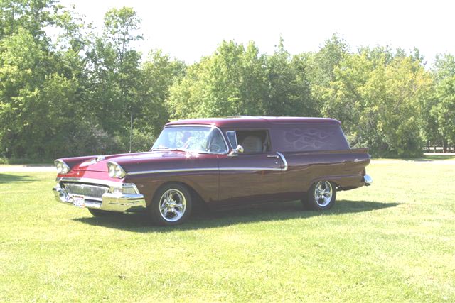

    I have a 58 Ford Courier Sedan Delivery and have been battling brake pedal issues for a long time and I have decided to tackle it again. Front disc conversion from a 68 LTD. 11" with 2 3/4" bore calipers. Stock rear drums with 15/16" cylinders. I had a single 11 inch booster on it and it would stop on a dime but the pedal went almost to the floor. I determined that it was the pedal ratio and no way to modify the pedal. Ditched the booster and I have plenty of pedal but it pushes hard. I have tried 3 different bore MCs, going smaller but it still does not stop good. I want to put a booster back on, but have since went from a small block to an FE, so booster/valve cover clearance might be interesting. I am looking at a conversion from Jegs for a Ford pickup. I will try to attach a link. It appears that the bracket and linkage in this kit corrects that pedal ratio but I called them and the tech said he didn't think so. It also looks like the bracket would raise the booster up a couple inches which might help my engine clearance. I am on a budget and don't want to spend a ton on custom setups. I thought about getting smaller diameter calipers but these LTD spindles are really odd and nothing will bolt to them. If anyone would have any tips, I would appreciate it. Here is a link to that kit: https://www.jegs.com/i/JEGS+Perform...zUscbv_87gjHubGCcl_W6LG8UwWOGv0AaAm6IEALw_wcB
