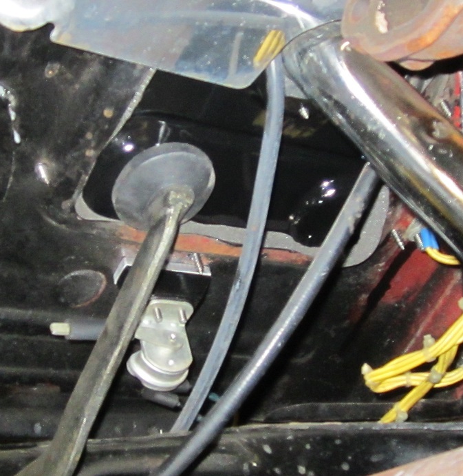

  12. Plug the hole with pipe thread plug and add a good quality (NOS or old NORS) brake light switch from a 50s Chevy truck.
    Here's my '41 with a stock master (I used a banjo bolt that didn't have the hole for the brake light pressure switch on the master).

    I had similar issues with the hydraulic switch, removed it and used this on firewall under brake pedal similar to post #12. easy to fine tune (Adjust)
