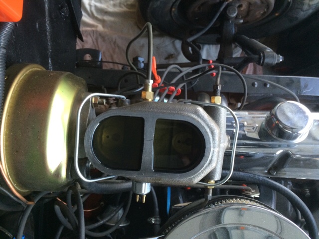

    I'd first agree with the others in that we need to see a photo and hopefully a part number on the master cylinder you are using. I don't believe it is intended to have lines run of both sides at one time but may be wrong on that. That style is usually a "multiple application" unit that allows the builder more options as to how he wants to run the lines from the cylinder.

    According to Speedway, the master cylinder I have is a GM master. The part number from Speedway is 9106001. I think y'all are right about not using all the ports.

    ImageUploadedByH.A.M.B.1417467012.475671.jpg ImageUploadedByH.A.M.B.1417467030.123513.jpg
    These are pictures from online. I'll take some pictures of my mounted m/c when I get home.

    ImageUploadedByH.A.M.B.1417476163.863317.jpg ImageUploadedByH.A.M.B.1417476177.859820.jpg ImageUploadedByH.A.M.B.1417476191.141414.jpg ImageUploadedByH.A.M.B.1417476205.276507.jpg
    These are actually on my truck.

  28. You don't want to hear this, but I'd feel I need to at least try.
    That booster is ****. It's too small for a Fiat, much less what you're trying to do with it.
    As someone posted, get a system from a similar vehicle, and burn that Speedway catalogue for the heat value, used the way you're using it will likely get you killed.
    Next, reinforce the firewall!! It will, I mean WILL flex, crack and break with the load you're putting through it with the brakes. And I am 100% sure you have not tied the pedal ***embly to the dashboard, as in every car made with hanging pedals, ever. Guess why the factory engineers do this.
    And dare you think this is me talking without benefit of experience, you now get a dunce cap to wear. Further, I always get a matched pedal/booster/master ***y, and I always tie it to the dash and a reinforced firewall.
    I'm not even going to start with the brake switch, adaptors, lack of proper line support AND routing. Sorry, sir, but you are in over your head.
    Cosmo
    P.S. Does that one line REALLY go into the air filter?!?!?! Holy Cow!!!
    P.P.S. Did you really thread a pipe thread switch into a inverted flare fitting??

    Well, Jack***, thanks for reminding me of why I hadn't joined a forum up to this point. No, dummy, the brake switch isn't threaded into the M/C. It is screwed into an adapter that it was already attached to from the original setup. I'm using it to plug an unused port right now. Next is the lack of proper routing and support for my lines that I must have been an idiot to do this way. Well, dip****, it's pretty well pieced together at this point well enough for me to troubleshoot the issues. Once I get it working like it's supposed to, I'll make it all nice and pretty.
    People come to forums like this to learn from folks who have more experience, not to be treated like they are stupid. Unlike you, who works at a parts counter and gets to hear everyone's successes and failures, I fight for living. Wish you could come talk to me about the subject I'm more experienced in. How about next time you want to talk to someone like they're an idiot you do it while they are standing in front of you and see how it works out.
