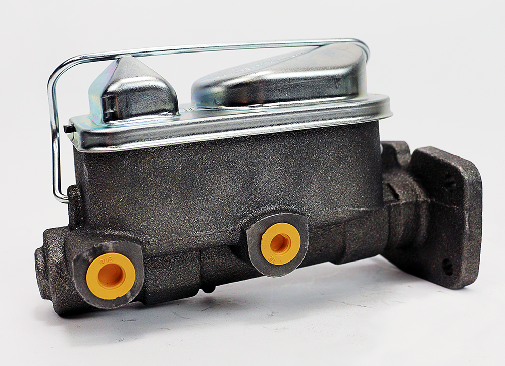

    I believe my MC cap is non vented, attached is a picture.

    Your cap should be vented to the top of the gasket. If nothing obvious on top, look around the cap edge for a relief.

    That style cap should have a bump somewhere on the gasket surface, this is where are moves in and out, above the diaphragm.

    Your master looks like a typical late '60s-'80s disc/drum master, not a disc/disc. Make sure you don't have an internal drum brake residual in the front portion (secondary) of your master.
    Keep the fluid level 1/4" from the top on that style master.

    The master cylinder in your picture is a disc/drum master cylinder, not a disc/disc master cylinder. Being that it has 4-bolt holes, it appears to be Mopar in origin.
    I cannot say that this is a guaranteed issue here, but none of the listed components are "designed specifically to work together".
