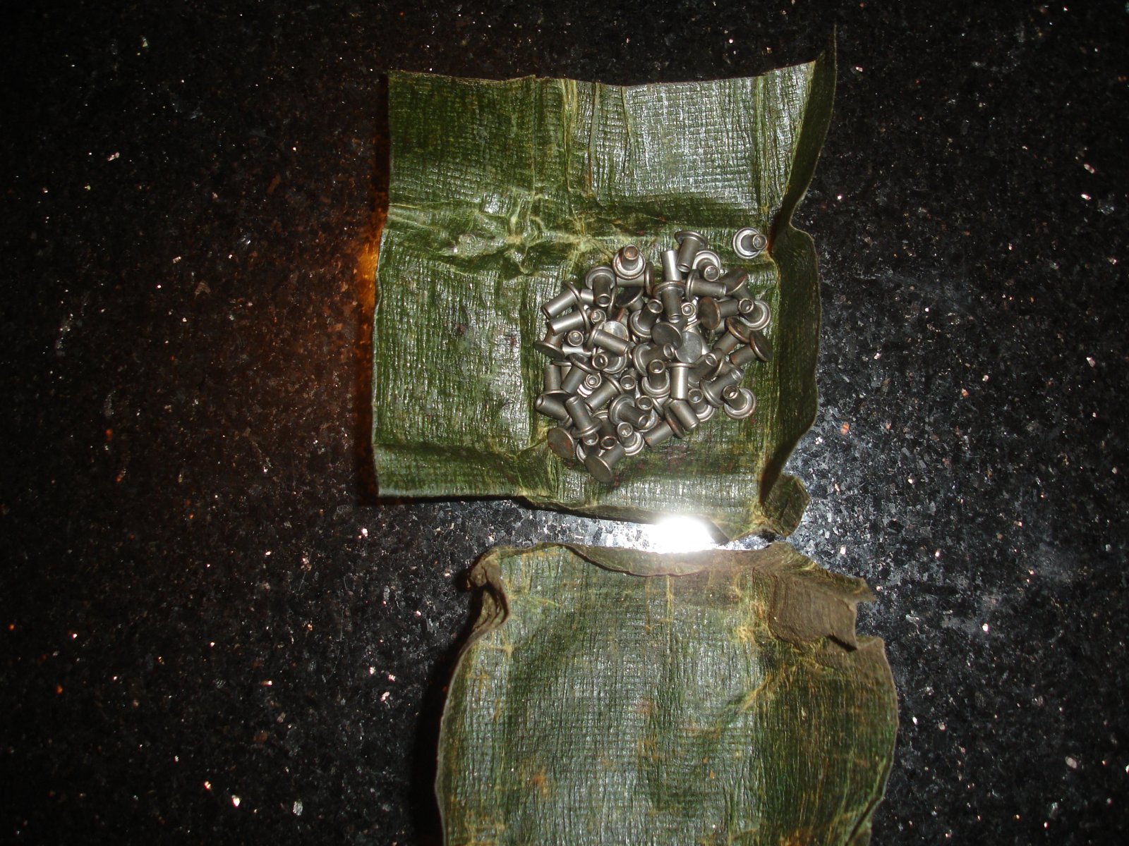

    I have a set of rivets that were supplied with the linings for my 40 I bought from Joblot back in the 70's. I measure them, head is .295 od, shank .143 od, shank under head .275 long, hole .133 deep. They are steel and worked on my shoes. That are still on the car. Here is a picture of them in the cloth folder they came in. If they will work for you PM me your address, I'll send them to you.
