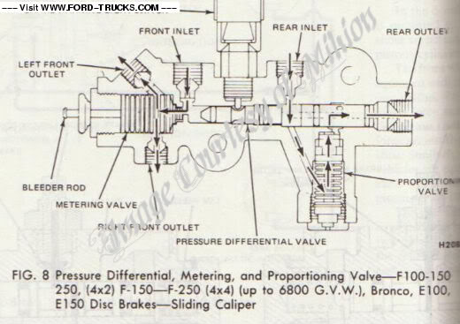

    In an effort to find more info & in response to what's been said here concerning combo valves , i offer this ; some valves are for distribution plus a pressure activated warning , some include those plus proportioning (it seems of rear brakes only ) some include metering also . The function of the" safety " aspect remains a mystery , some accounts say it "closes off" the leaking part of the system , some say it doesn't . here's the best picture I could find that : Distributes , Meters, Activates the safety lite & proportions. hope this creates more understanding
