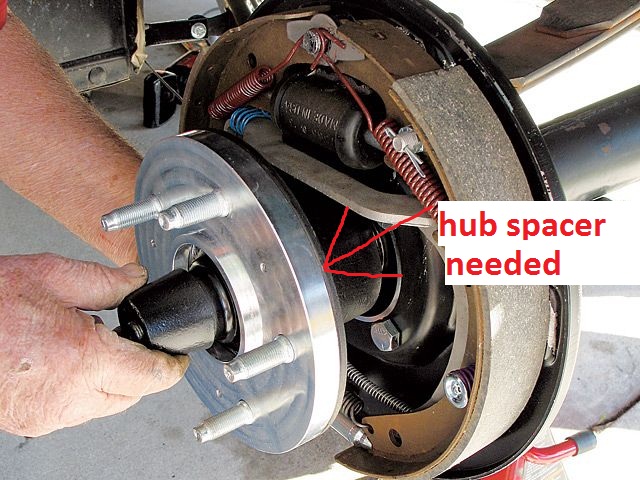

    i found these pics in a rod and custom magazine tech article
    basicly im after these spacers for fitting my lincoln brakes to my model a
    in the article it says that mt car products supplyl the spacers with the kit but i got no reply from them
    i could make the spacers myself but thought i would see if i could find some for sale first
    have any of you found or made some

    Speedway sells the spacer kit. And I'm sure Mac's and the other old Ford suppliers do also.

    m/t car products in currently in the process of selling their business. they no longer sell the spacers but they do sell lincoln backing plates specific to the early spindles. i believe they will bump the shock link. we have them available and in stock.

    make sure they're the ones specific to model A spindles. most are standard 1940 ford style or standard lincoln style that will require the spacer. i can't imagine they would be that difficult to make, though.

    I looked for those spacers when I did the juiced conversion on my A and couldn't find them. I just went with the reindexing the backing plate as shown on the tech pages here then got some 1/4" wheel spacers off ebay to space out the drum from the backing plate so I didn't have to machine anything and have been running them for 2 years now with no problems. Not sure if you wanted to keep the backing plate straight up for looks though. That is why I was looking for the adapters.

    i have got some spacers that will be the right size between the drums and hubs but i was hoping to get the right ones
    i have fitted the backing plates for now but thought while im getting the drum spacers ill try and get the other spacers to
    and thank you uncle bob for the link but the adaptes thay sell i have and are for the front brakes its the backs im having trouble with
