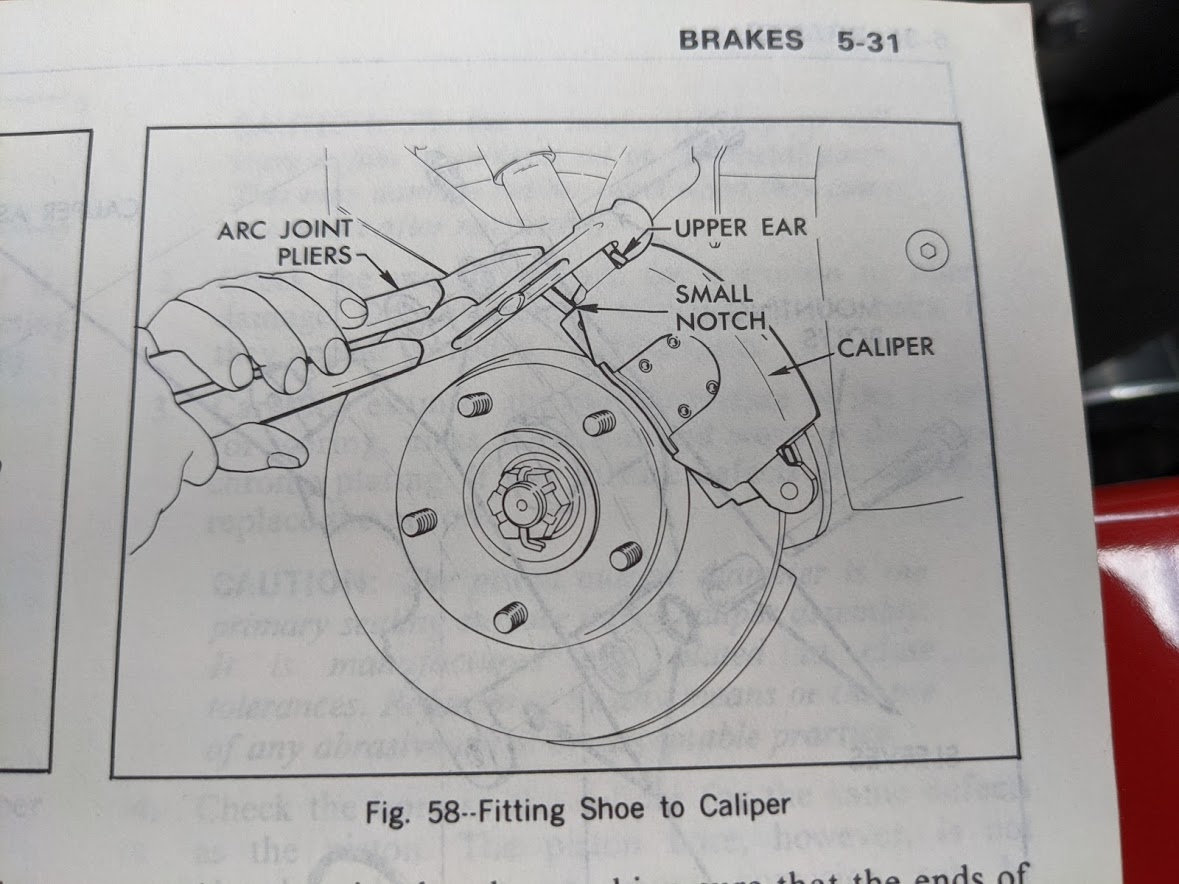

    There is a tab on each end of the outer pad on many GM disc brakes. The tabs need to be bent, or crimped, so they are tight to the caliper. Use a large pair of Channellock pliers, apply force to the pad at both arrows, till the pad cannot move around any more. Do both ends of the pad, I only put arrows at one end, but the other end has a tab, also. This is just on the outer pad.

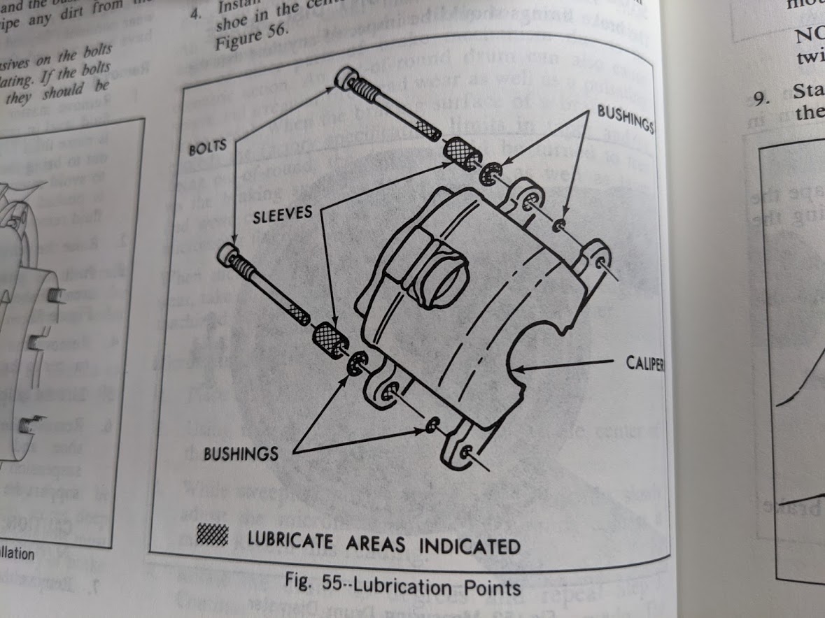

    and there need to be O rings in the grooves in the caliper, at each end of the bolt holes. One big, one small, for each bolt. The large one goes around the sleeve that is on the threaded end of the bolt.

    No problem. This info has been hiding in the Chevy ch***is service manuals for 50 years..you'd think somehow it would make it to the internet? Huh.

    If the outer brake pad is loose, bend the long tab up. It's kind of hard but make sure you don't crack the lining. Just bending the two little tabs like in the example above will not work in the long run, they will loosen back up and rattle again.
    I put a piece of clean plywood against the lining and put them all in the vise. Then use a heavy mallet with a big chisel and give the long tab a couple raps. Then see if its tight. I like to get them so I have to use a pair of channel locks to get the pad in the caliper.. On some brake pads I can get them in the vice and bend them up. I prefer this method over the hammer.
