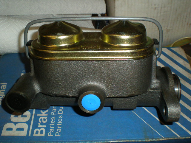

  16. RICH B
    Joined: Feb 7, 2007
    Posts: 6,144
    RICH B
    A 1" bore '67 Mustang drum/drum master cylinder usually works with Ford Lockheed brakes as long as they are properly adjusted.
    Most of the times these come with built in residual check valve; but it is a good idea to check for sure. If you gently poke inside the port with a paper clip or something similar and there is a check valve you will feel the spring loaded disc. If no valve use a 10 psi external valve on each port.
    The reason you didn't see residual valves on original cars is because it was built into the master cylinder.
    Dan Hay and rusty valley like this.
