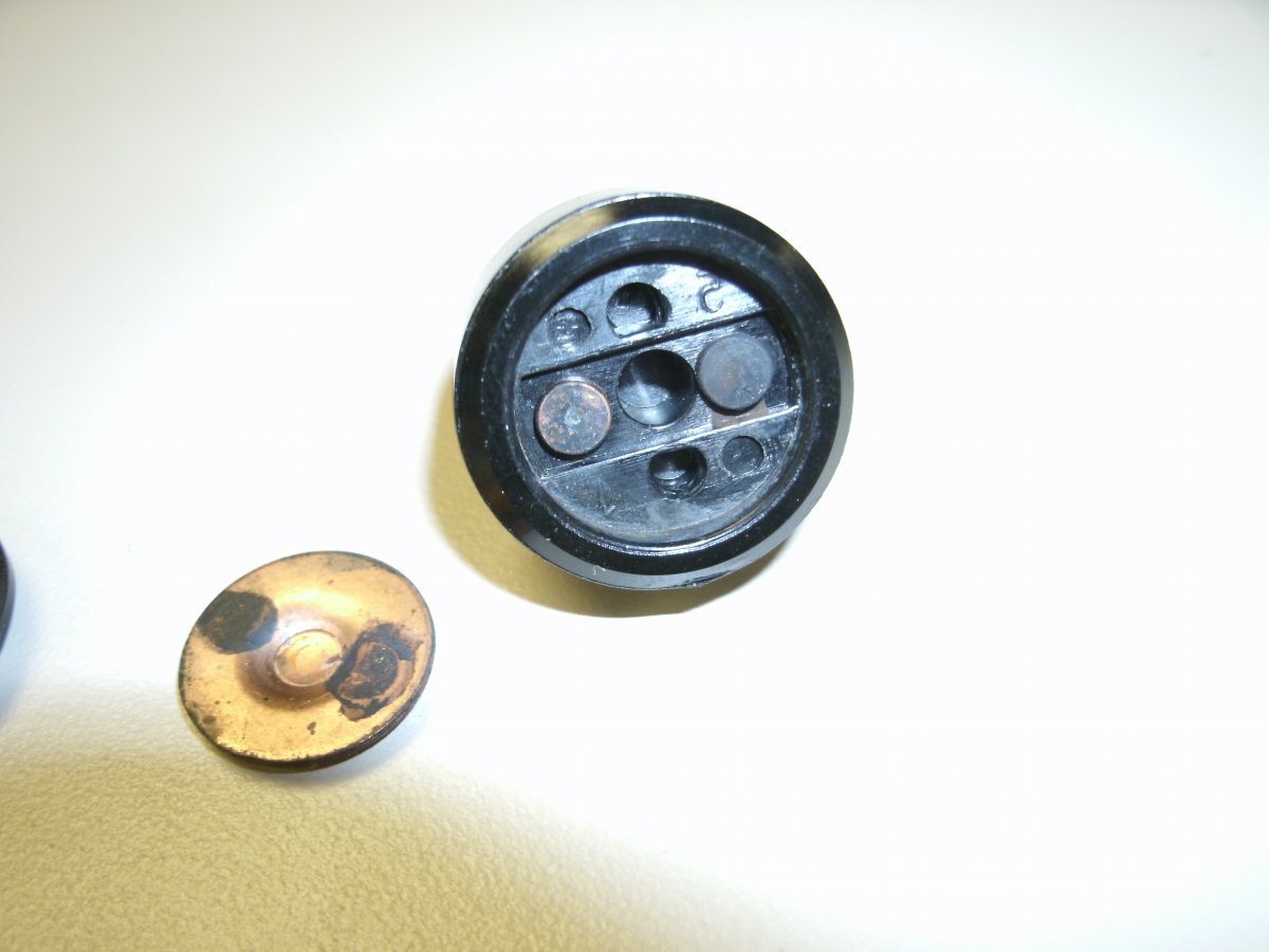

    I'm on my third brake switch in as many years. Tried different brands, all with the same results: failure. So I machined off the crimp flange on the last one because I needed to know how it works, and why it failed. Pretty simple design with the brake fluid pushing against the rubber washer, which pushes the disc to make the contact. There's a small spring, not shown, that sits in the center. Anyways, it appears the contacts arch each time the brake is applied, and over time builds up gunk (not sure of the technical term) which inhibits the electric flow. The two external leads are br***, but the disc appears to be copper. Is this a dis-similar metal thing? Just wanted to show anybody interested why these fail, and why GEDC0829.JPG GEDC0830.JPG I'm switching to a mechanical lever switch.

    Was it dry in there when you took it apart?
    Most times brake fluid leaks by the seal and messes it up in there. The next step is brake fluid visibly leaking out. New type brake fluid is more aggressive then the older type. That is why most cars since the 60's use mechanical switches.

    if you use a relay less amperage would travel through the switch increasing the life of it. there are different quality switches too. even in Echlin line. last time I bought the best one possible and it still works .

    I have a Napa switch in my Ford, the one that came with the CPP proportioning valve leaked fluid right away. I wonder if a tin-lead coating on the disc would have helped what you see going on with your switch, looks quite oxidized.

    Bob, Thanks for showing how that brake switch functions.
    I wonder if it could be modified so that it threads together and is sealed with an o-ring?
    It would be neat to make a proto-type.

    I would bet that the original switches had a solid copper disk to minimize transfer issues. If the replacements are not holding up, I would be inclined to look for an industrial grade Hobbs switch that would replace it or just do away with it completely with a mechanical switch on the pedal.

    high current flow burns , see the pulled material on the contacts ?? . and that's real copper ( not a alloy to cheapen it out ) use it to operate a relay . some of the old ones I took apart has silver plated contacts and the copper disc .

    it has to do with the time it takes to turn your brake lights on and off. its not a snap switch like a toggle or a light switch. the hydraulic pressure moves a bit slower and is variable so there is plenty of time to arc and destroy the contacts.

    Arc-over is your main issue. You can resolve it in several ways:
    1) Put a 1Mfd@25vdc capacitor across the connections.
    2) Use a relay or some other p*** device to reduce current through switch.
    3) Use a mechanical switch, which might be just as bad.
    4) Change stop lights to LED type if you have separate turn signal bulbs.
