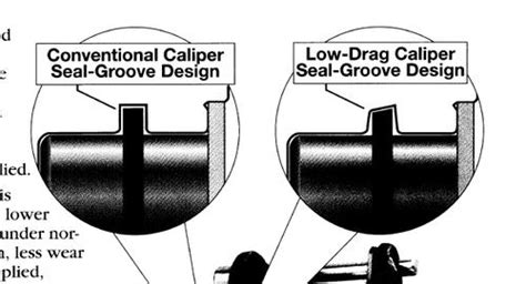

  11. Doublepumper
    Joined: Jun 26, 2016
    Posts: 1,997
    Doublepumper
    from OR-WA, USA
    The benefit would be increased volume and higher pedal. The down side would be increased pedal effort, due to lower pressure.
  12. gimpyshotrods
    Joined: May 20, 2009
    Posts: 24,629
    gimpyshotrods
    He said Chevelle/El Camino calipers.
    There was no Chevelle in the low-drag caliper era.
    CornfieldPerformance and Tman like this.
  13. Doublepumper
    Posts: 1,997
    Doublepumper
    from OR-WA, USA
    Yeah, I know. Was wondering how long it would take to call me out on it. That's why I posted pics of the two different seals. Just trying to be helpful through my keyboard. Carry on....
