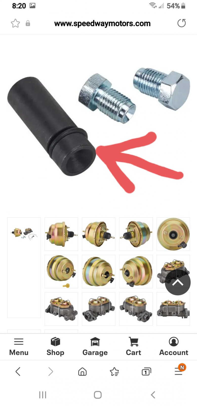

  4. Yeah I've had this issue before, and it sounds like you're using the Corvette style master with the 2 retainer clips on the cap. Sounds like you've nailed down the rod going into the master from the booster since you stated you have .020 clearance. Every one of them I've used comes with a small extension that is needed to get the full stroke of the piston in the master. The last time i had this issue, it was the pushrod from the pedal to the master. I hadn't tightened the jamnut and the pushrod had backed off. I didn't figure it out until the 3rd master cylinder.

  28. So it's not a situation where the master cylinder isn't getting full stroke then? 20211103_202315.jpg
