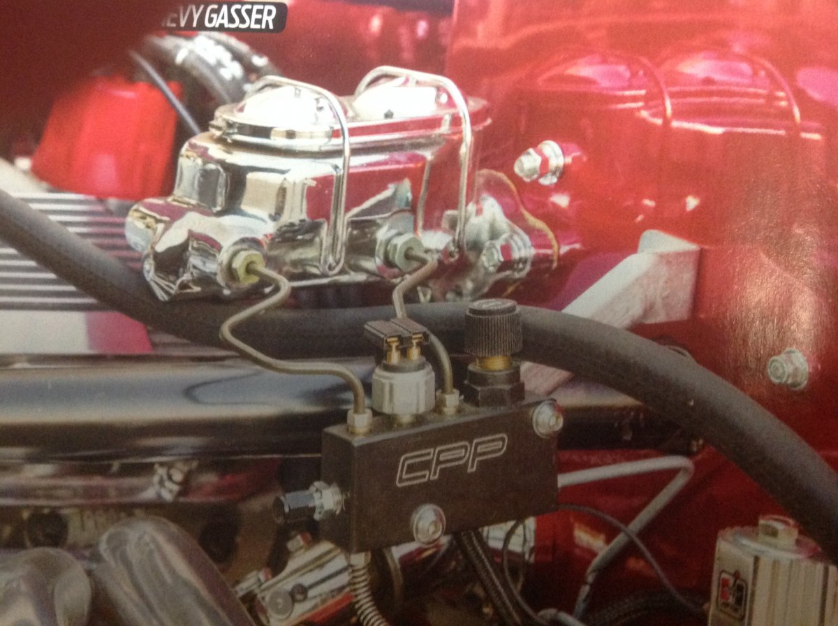

    image.jpeg CPP has a portional valve that has a brake light switch and a adjustable rear brake all built in. See September issue of Hot Rod page 54 and there is one on a 55 Chevy. First one I have ever seen. Frank
