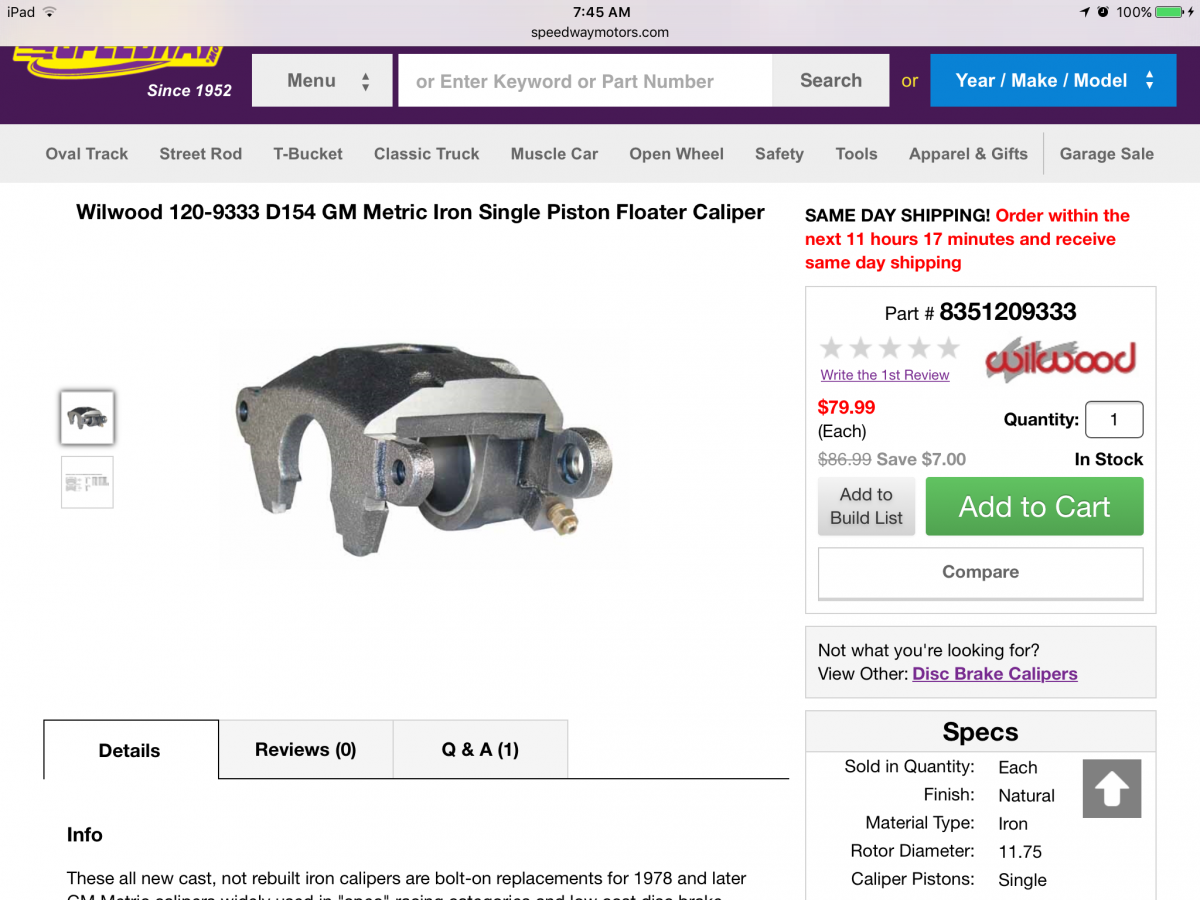

    http://www.speedwaymotors.com/Wilwo...Iron-Single-Piston-Floater-Caliper,24242.html
    These are Available in 2-3/4 or 2" bore.
    I've used them in 2" and the light weight car stops perfectly.

    BTW, I already have the 2" (metric?) calipers from Speedway. Plus, an after market adjustable proportioning valve that doesn't have a shuttle in it that does what Kerry is describing with factory proportioning valves. It's just like squeezing the brake line with a vise grip! :eek::rolleyes:;)
