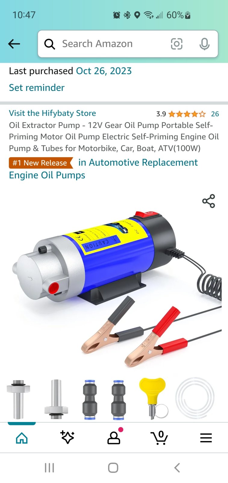

  18. Matthew Davis
    Joined: Nov 9, 2022
    Posts: 38
    Matthew Davis
    We are good to go. We ordered this little oil transfer pump from amazon, cracked the brake line on the upside-down wheel cylinders and forced it through the bleeder. We did this before but without the pump and after thinking about it realized our first attempt was too little fluid for too short a time. I just wanted to post a follow up in case someone in the future runs into this issue and comes across this thread.
    loudbang, partssaloon and pprather like this.

    Not sure what the oil transfer pump cost, but when I was wrenching, we had a hand operated unit called a ''mytvac brake bleeder''. It was capable of vacuum, or pressure bleeding, depending where the supply hose was connected to the reservoir.
