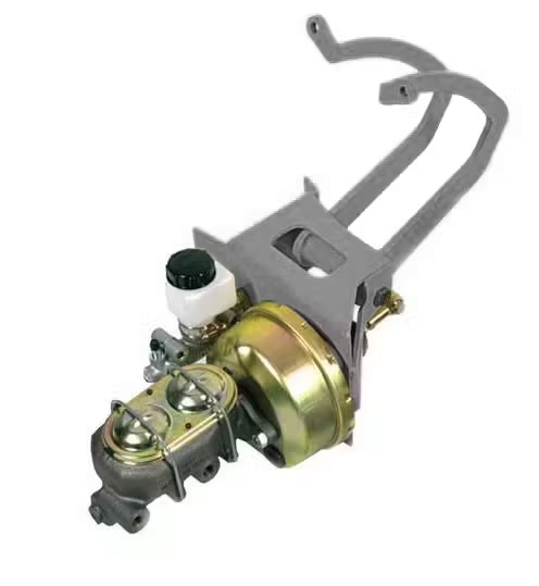

    The car came with the TCI master cylinder/clutch ***embly installed: https://www.speedwaymotors.com/TCI-...er-Brake-Hydraulic-Clutch-***embly,46286.html
    I currently have no pressure in the system. After several calls to Speedway and TCI I 'think' we found the issue. Since it has the power booster, the master cylinder needs a 'plug' so the booster pin can contact the piston. That wasn't installed, so there's too much throw before the pin contacts the piston. Hence, not enough travel to provide useful pressure. And yes, the master cylinder and lines are bled, no air.
    So, the main question now.
    The master cylinder can be used with or without the booster. There's a bit of work involved to make the power brakes work and serviceable. Those are:
    Run a vacuum line from the manifold to the booster. Easy, but I don't know if the engine will provide enough vacuum on its own (49 flathead v8). If not, I need to find a place for a vacuum canister (challenging).
    With the booster, the master cylinder sits right under the cross body support under the front seats. To access the master cylinder lid, I'll need to modify that support and frame it around the lid. Challenging.
    The master cylinder (Corvette style) can operate either manually or boosted. If I remove the booster, I can move the master cylinder forward and in front of the cross body support. And I don't need to worry about vacuum.

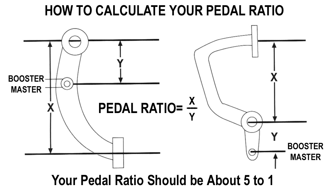

    Rule of thumb is 5 to 1 pedal ratio for power, 7 to 1 for manual. Check yours.
    https://mpbrakes.com/how-to-series-correctly-calculating-brake-pedal-ratio/

    Thanks, the poor access is only to the master cylinder lid when the body is on the car. Right now, it's a rolling ch***is, so access is good.
    It is a 5-1 pedal ratio. Unfortunately, it looks like I need to remove the transmission to pull the pedal for modification or replacement. The pedal pivot bolt is too long to extract otherwise. Maybe I can make a bolt-in ratio 'changer'...

    Good point on the taller pedal. And it would much easier to access. Though it would add 3 inches to the height. Would be nice to just lose about 3/4 inch on the short end. We shall see.

    3 inches taller pedals? to increase ratio 5:1 to 7:1?
    Something doesn't add up. how can a 7 inch booster fit in a 6 3/4 area plus pedals?
    How far down is it from the pivot to the master rod?
    • Height from top of pedal ***embly to bottom of booster is 6-3/4"

    As your photo shows, the pedal is the type on the right.
    I had no idea where you came up with the 6 3/4" measurement until I looked at the Speedway site. They have it wrong - it's 15 3/4".
    The actual measurements are:
    Top of pedal to top of booster = 8 3/4 inches
    Top of pedal to bottom of booster is 15 3/4 inches
    However, you DID make me re-measure wearing my reading gl***es, and X was way off (10.125 inches vs. 9.0)
    Thanks for that
    As is: X=10.125 inches, Y= 1.75 inches, yielding 5.8:1
    To get 7:1:
    Shorten Y - 10.25/7 yields 1.45 inches, shortening Y by .30 inches. (new result)
    Lengthen X - 1.75 * 7 = 12.25 inches. Lengthen X by 2.125 inches (new result).
    If I were to guess - TCI uses the same pedals and frame for manual and power brakes. The ratio is almost 6:1, which is a compromise between 5:1 and 7:1.
