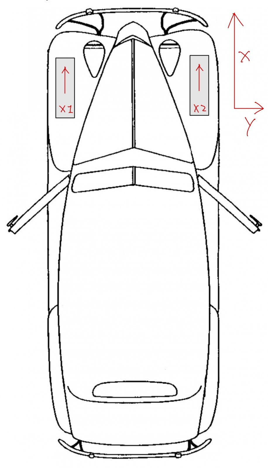

    It is widely known accepted wisdom that brakes have to be set up such that the fronts lock up before the backs. Every thread on brake proportioning, whether fixed stock or aftermarket adjustable, every thread on brake design, whether disks or drums, eventually includes the warning that the fronts must skid first or the rear end will try to come around. The OEMs set their brakes up this way, and early anti-lock systems were rear only. The question isn’t whether this is true, the question is why? What is the physics that makes this happen?
    Working from a simple case first, a basic four wheel braking system.
    If the car is traveling in a perfectly straight line, only X has a value. Y is 0. If we brake, and remain straight, then X changes, Y does not. As we brake harder, approaching the maximum braking that the available traction supports, X changes faster, but that doesn’t change Y.
    At some point, we run out of traction, and wheels begin to slip. Braking is reduced at the slipping wheel.
    If Y is non zero, then locking the rear wheels would obviously induce a slide. So how does locking up the rear wheels first change Y?
    I spent a lot of time on a bicycle as a kid. One brake on the rear. No matter how many skid marks I left on the driveway, the rear end never came around on me unless I added steering input to make it happen.
    I think the answer is that there isn’t one X here, there are two.
    As we brake, the front wheels are not experiencing exactly the same traction at any given instant. If the rears are locked and sliding, whichever front side gets better traction will induce a change in Y causing the rear to slide toward the other side. Once Y starts to change, braking is no longer in a straight line, and the feedback of Y changing induces more change in Y. This is experienced by the driver as a sudden uncontrolled spin that may be catastrophic.

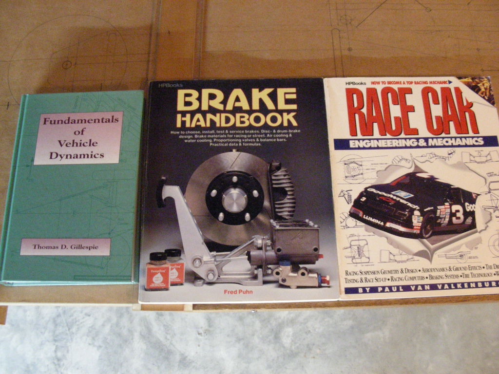

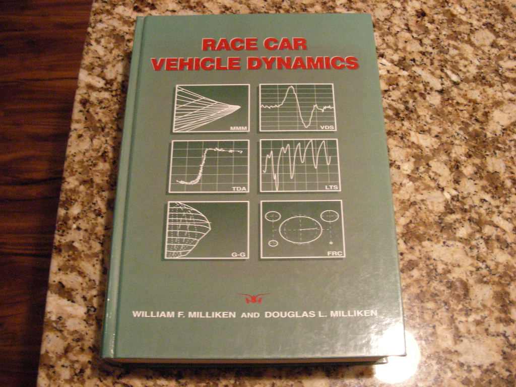

  8. Dave G in Gansevoort
    Joined: Mar 28, 2019
    Posts: 4,035
    from Upstate NY
    If you really want to know the dynamics of braking, here are some books that you're going to want to read. DSCN1469.JPG DSCN1468.JPG The green book, The Fundamentals of Vehicle Dynamics was the text for a graduate level course at the University of Michigan (go Blue).
    The first book by Milliken and Milliken is a very complete treatise on race car vehicle dynamics, and explains tire fundamentals in great detail. Which needs to be understood first.
    Beanscoot and bobss396 like this.

  17. David Gersic
    Joined: Feb 15, 2015
    Posts: 2,819
    David Gersic
    from DeKalb, IL
    A spin is bad. It won’t help you stop, at least not until you hit the ditch, guardrail, or tree. Then the sudden deceleration will probably hurt a lot. With a spin, most of the time you’ll have all four wheels sliding, so will be at less than threshold braking.
    I’ve spun cars. I can’t recommend it.
    The driver has to react to the situation, and doing that successfully takes practice. Mostly doing it wrong, and learning what wrong feels like until doing it right becomes reflex.
    Image is a 37 Chevy. I wanted an overhead line art view, and had that one handy.

  20. David Gersic
    Posts: 2,819
    David Gersic
    from DeKalb, IL
    That’s what I’m thinking, basically. Sliding is less friction between tyre and ground, so the front is trying to decelerate more than the back. With any side motion, then the rear comes around. And the imbalance between the fronts acts as a lever to rotate the car.
    Exactly right. Greatest braking is just before lockup. You don’t want lockup, you want to stay just this side of lockup.
