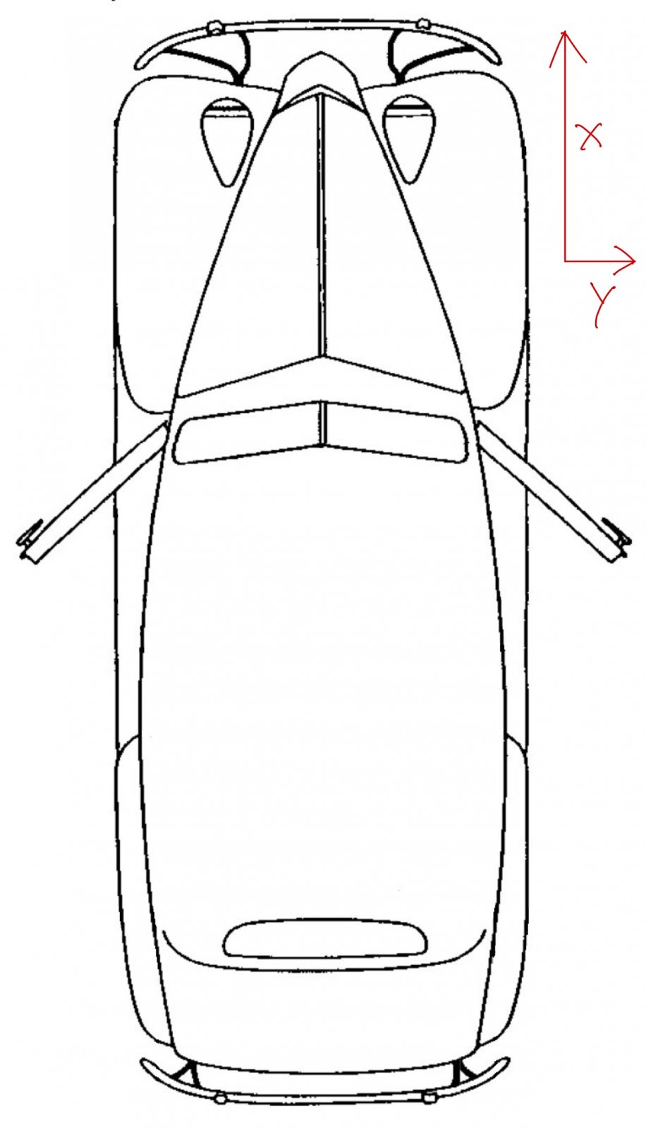

    "Y" is also affected by the camber of the lane you are in.
    Also consider it likely the automobile in question is not loaded equally side to side, so even if the front wheels have equal "X" force, the uneven loading of the vehicle will impart a force in the "Y" direction.
    The best way to avoid the endo swap: Well adjusted brakes, a calm demeanor, driving within the safe parameters of road and weather conditions, and most importantly situational awareness.

    Uneven loading, weight transfer, road surface and angle are inputs I was ignoring, trying to simplify. There are many variables in this dynamic system. Even each of those has its own list of variables to be explained.
    Agreed. A well functioning system, don’t panic, and safe driving techniques should prevent the panic stop / brake lockup.
