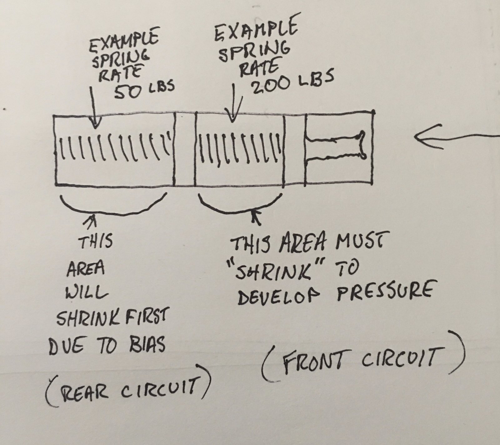

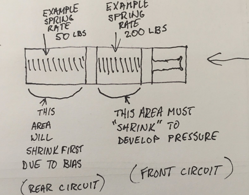

    You are the first one in this post to allude to the way a “modern” brake system is designed to work. Rear brakes set up first at low pressures. Since every new brake application starts at low pressure, the rear brakes, by design always apply first.

    Initiation of brakes is specific to vehicle. The exceptions to my description would be cars that were designed with cross braking systems. Cars with cross braking use specific master cylinders with zero bias springs between the pistons in the master.
    There are also stepped bore master cylinders that can either output separate pressures or equal depending on if they are linked with a specific rod diameter.
    Take a typical master cylinder apart sometime. How is the fluid compressed in the rear most chamber?

  11. TRENDZ
    Joined: Oct 16, 2018
    Posts: 386
    TRENDZ
    There is a huge difference between lock up and initial application.
    The key is that on a dual circuit brake system, there is bias in the two springs in the master cylinder. Some use the combo valve to achieve the same end effect. This isn’t an “every last one of em” statement, but a huge majority. In most cases, you will achieve around 120-150 psi in the rear circuit before the front develops any pressure. From that point on, the pressure equalizes because the force exceeds the spring bias.
    As for stepped bore masters, browse through parts catalogs looking for dual rear axle hydraulic brakes. CB0E35C2-505C-4A08-810E-ADA502FC6F71.jpeg

  13. TRENDZ
    Posts: 386
    TRENDZ
    ***uming all drums are the same diameter, and all shoes the same width, you would want the larger bore wheel cylinders on the forward axle.
    As for master cylinder bore size, I prefer the smallest bore that allows for safe pedal travel.
    If the pedal travels to much (after proper bleeding and adjustment), step up in size. The smaller the bore on the master, the less effort it takes to achieve full pressure (at the cost of more pedal travel)

    You are referring to " I personally believe brake modifications in the hands of idiots is dangerous [some people learn, and some people let their egos make stupid decisions]"
    I stand by this comment ^^^^
    Below is a cl***ic example of somebody chiming in with "Their almighty superior knowledge" and get it totally wrong.
    Let's hope for the sake of other members, that they realize he is only trying to win an internet argument ,so please don't take this as gospel
    The springs inside the M/C ^^^^have no influence on line pressure or clamping pressure at all.
    In theory ,if the springs were removed or swapped around the line pressure or clamping pressure would remain exactly the same.
    The springs will affect the pedal effort slightly. The purpose of these springs is to help return and locate the pistons [they use 2 different stiffness springs so the stiffer spring can locate the floating piston position more positively]
    Line pressure [or working pressure as quoted] is a factor of fluid mechanics.
    "Pressure is Pressure" and "Volume is Volume" they shouldn't be confused.
    There is no co-efficient of friction until ALL the clearances of the friction surfaces have been taken up, AND further pedal pressure is applied resulting in clamping pressure [and line pressure which can be measured easily]
    Usually there is more clearances in drum brakes, so more volume is needed to take up clearances before pressure is built up.
    Usually a small amount of pressure is needed to overcome return springs [but there is no clamping pressure at this point]
    Even at this point ^^^^ the line pressure is equal in the whole system [because the floating piston in the M/C will meet a point of equilibrium]
    A quick summary....There is no pressure in the system until the fluid is met with resistance [all clearances taken up]
    When doing calculations for brake systems on race cars , we use an arbitrary 0.005" crush on all friction surfaces to help calculate Volume.
    Just remember....."Pressure is Pressure" and "Volume is Volume"
    And if you're out of your depth, please leave braking systems alone [people's lives are at stake here]
