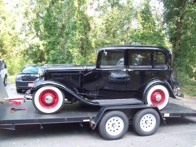

    It was a nice fall day and we decided to take the 32 mordor to the V8 club's picnic at Lake Greenwood,we left home at 8:30 AM to meet up with the 4 others going to the picnic.
    the trip was uneventful but when we arrived at the shelter I pushed in the clutch to back into the parking space and the clutch would not engage and you all know the sound that makes.:eek:
    After lunch I borrowed a jack and raised the car up enough to adjust the clutch linkage and everything was good.
    A couple of hours later we bid our goodbys to the guys from the lower part of the state and set out to go home,,,
    Just when we got to the front entrance of the park I pressed in the clutch and heard a snap and the the clutch pedal went to the floor.
    Several guys helped push the car to a shady spot and I got the jack again but already knew it wasn't going to be a simple fix,,sure enough the pivot ball for the clutch arm had snapped.
    Nothing any of us could do this far from home except get on the phone for help and a trailer,I told all the other guys to go ahead and head for home,nothing to do but wait.
    Brenda and I talked about it and there was nothing to get upset about,it can be fixed when I locate the part.
    I've been close to 17,000 miles in this car over the past 13 years and I guess the law of averages finally caught up with me.
    About 2 hours later my pals Dave and Steve arrived with a trailer and we got the car loaded.
    After a long day we finally arrived home around 6:30 PM but due to the way my driveway around to the back of my house narrows and turns sharply we unloaded the car from the trailer and pushed it around behind the house up a slight hill backwards with my wife driving and all this went well.
    Then I got in my pickup to pull the car uphill to be able to back the car down into the old shop,everything was fine until I heard a horrible sound,like running over a cardboard box but it wasn't a cardboard box,it was the front splash apron being crumpled by the tow strap that had slipped from the position I had it on the axle.
    They ain't all great days,but I do have great friends and my to do list had just got a little longer. HRP

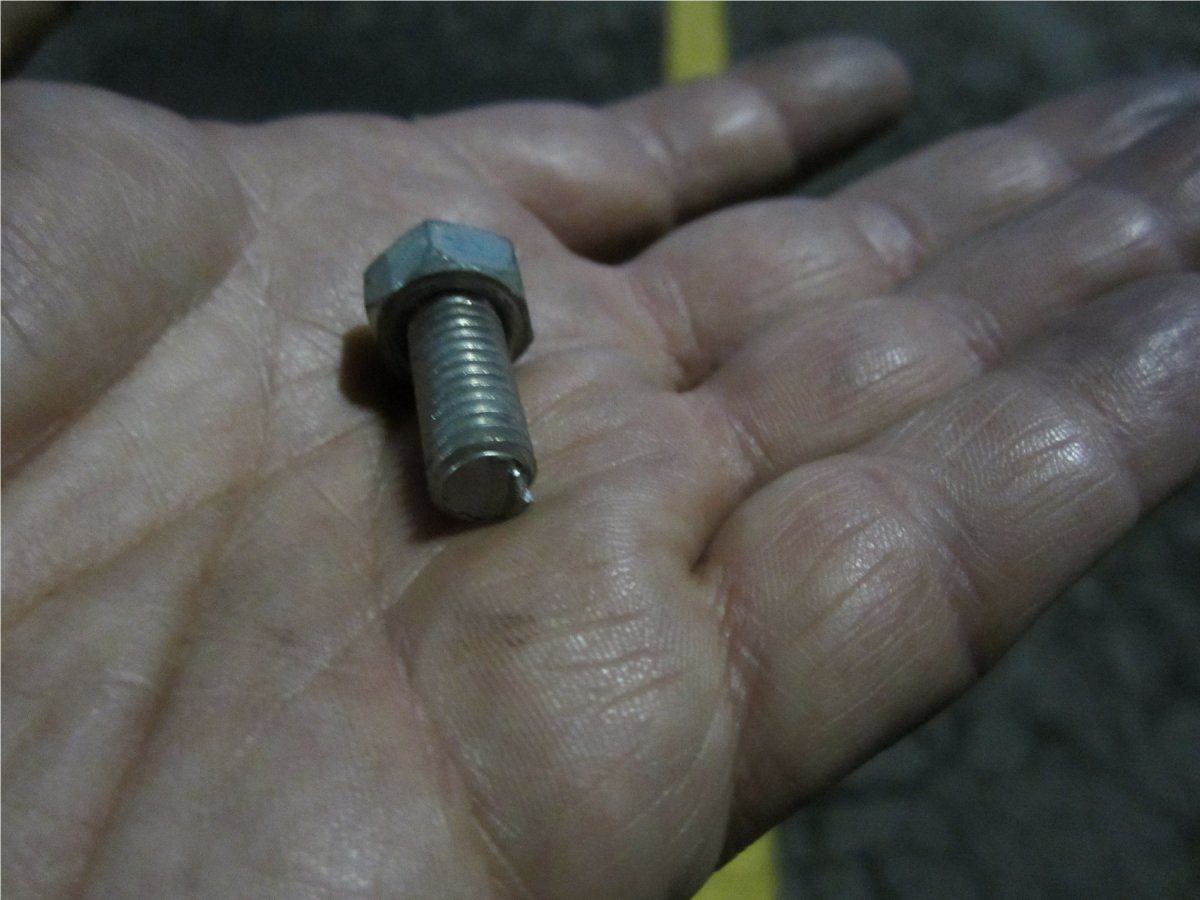

  16. Always carry a toolbox and some spare parts. Here's a few I captured,
    Alt bolt
