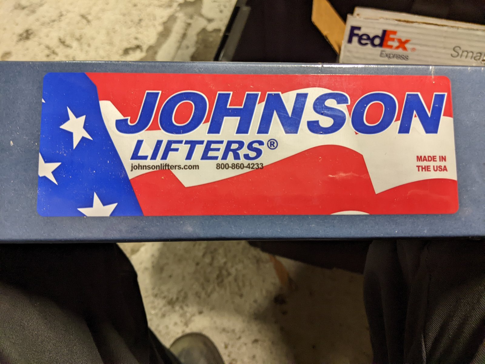

  18. gimpyshotrods
    Joined: May 20, 2009
    Posts: 24,583
    gimpyshotrods
    My Johnsons were made in the USA!
  19. RmK57
    Joined: Dec 31, 2008
    Posts: 3,220
    RmK57
    I have brand new set of Comp Cams solid flat tappets I never used. Decided to get my Johnson flat tappets reground. I have 145 lbs. on the seat and 360 open valve spring pressure.
    Johnson doesn't make flat tappets anymore, although you can find them nos on eBay......
    Atwater Mike likes this.
  20. Running Johnson’s lifters.
    No issues 18 months in
    5 years ago we built a 350 with Elgin.
    No issues with those either.
