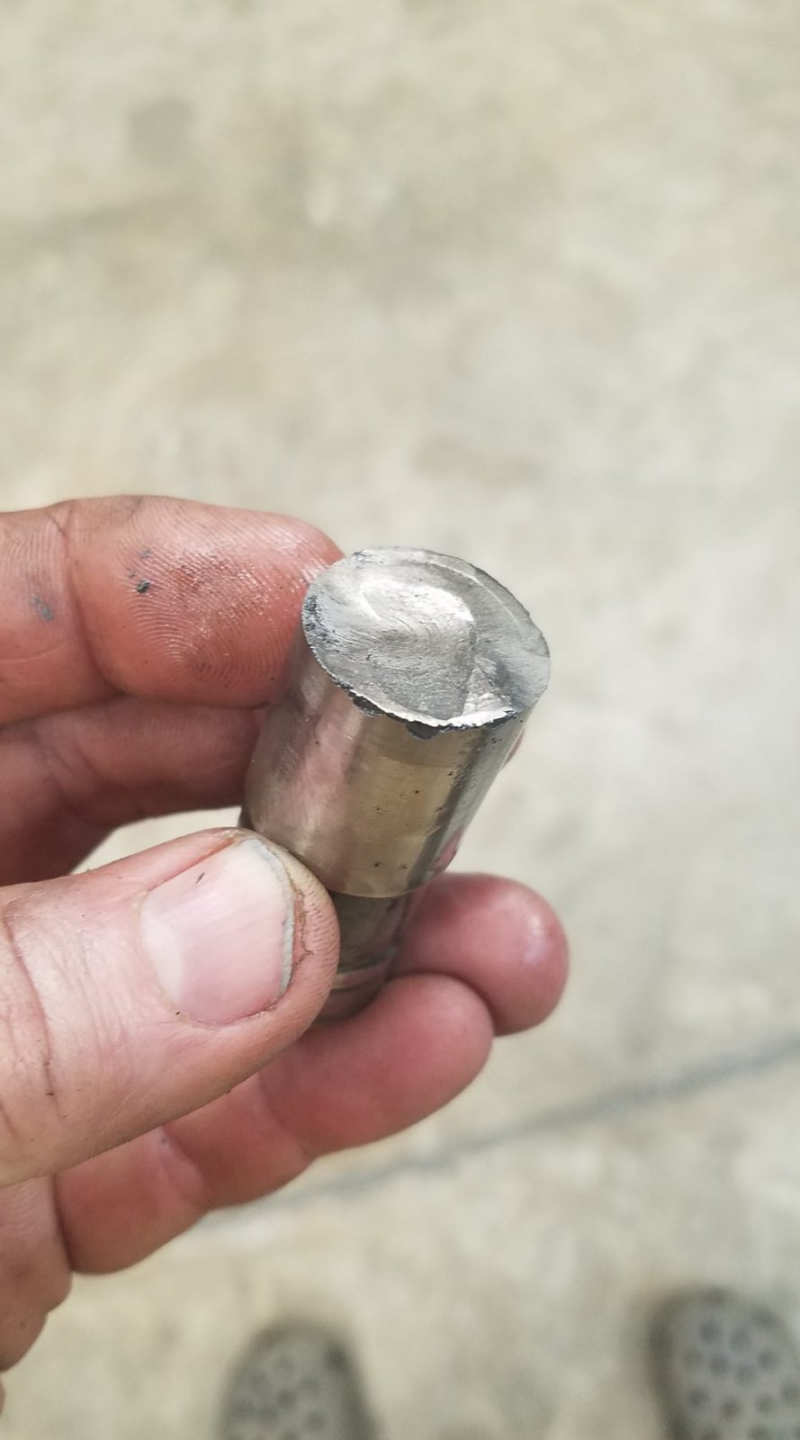

    My Johnson HT-900 were US made, too, supposedly. Wiped a lobe right off my Crane cam.
    I ***embled with cam lube, used high-zinc VR-1oil and did the typical break-in at rpm for 30 minutes like I've done plenty of times before. The weird thing was that it didn't show up right away but a couple thousand miles later. I'm guessing it had a shallow hardening depth and when it finally got to the soft spot...
    There's some info out there that these are being remanufactured and not properly heat treated. Other info says they are foreign-sourced. Who knows? I do know that I will only use roller lifters going forward.
