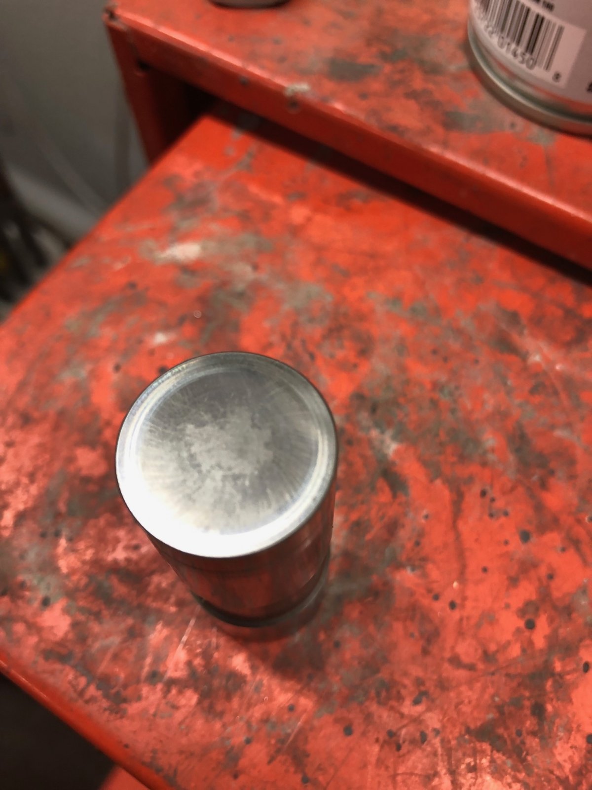

    It is a Melling cam and lifters and hope its just a bad lifter but will find out today.

    Pulled the intake and four bad lifters and came from close to the middle of the cam,cam not hardened correctly or bad lifters?. Cam is coming out tomorrow and will most likely get the used cam if it checks out.

    After further investigation it looks like one lifter did not spin amd the debris got in the surrounding lifters,the one was worn uneven and the rest were fine.

    As the gang may know, cam lobes have a slight taper, at the nose to promote lifter rotation, along with a slight crown at the face of the lifter , this can be about .003" -. 005" from what I have measured with a micrometer. Still doesn't account for material quality. Excessive lifter bore clearance may affect the rotation, but that would let more oil dump onto cam lobe. I only use heavy moly lube on cam and lifter face , and run new synthetic oils, because they have additives that cope with high contact loads like the high pressure fuel pump on direct cylinder fuel injection. The ZDDP in a bottle additives can compromise the ability of the base oil you use, I avoid them. A ton of zinc is not a good thing, it is the total oil additive make up and starting with quality components that should prevent failures, not always easy. Remember 40 years ago, a cam kit from the corner speed, a can of GM "EOS", and a burn out in front of your girlfriend's house and you were good to go! No longer.

    I lost two cams over a lifter not spinning. Both times just one lifter of the eight and lifter bores sized and working correctly. I don't think the lifters were of even hardness across their face and suspect only surface hardening because they wore fast and deep quickly. I used frequent oil changes to clear the debris and both engines are still here running today.

    Got it apart and has two torn up lifters and a few more from around those two that probably got debris so cam is toast,trying to make a deal on a low mile 292 Y block so this 351 will get the used cam if it ckecks out and will not get used toouch longer.

    So how do you find out the lifter didn’t spin after the fact? Once it’s worn and mushroomed out it’s probably not going to spin right?

    You can take the rocker cover off and use a white felt pen to mark the pushrod. Start the engine and make sure all of them spin. In my engine some would turn about a third of a turn per revolution, others were maybe about eighth of a turn but they all rotated.

    When I pulled the lifter the wear was very uneven
