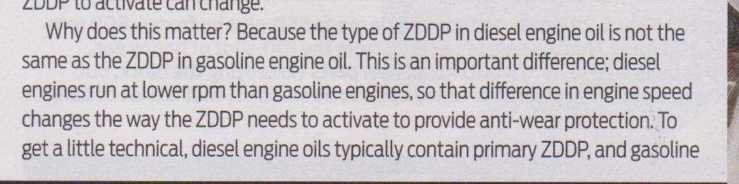

    The latest issue of Hot Rod (0223) has an article about ZDDP additives and their chemical composition differences. Apparently there are differences between ZDDP for diesels and ZDDP for gasoline engines. That would make you wonder about the wisdom of adding "off the shelf" ZDDP to existing oil rather than buying oil that is already configured for break in and containing the right ZDDP. I would post the article, but since its still on the newstand, it probably wouldn't be proper. Can't post a picture of the cover as its not Hamb friendly. Suffice it to say the car on the cover does not have a drivers door and the caption says ...."We Blew The Doors Off"
    It does say that too much ZDDP or the wrong ZDDP can actually harm an engine.

    Nope, all I did was point out that there are two different types of ZDDP (1 &2) as well as blends of 1 and 2. I also mentioned that from what the article says, the difference in their application was based on the rpm where the engine of choice operates. Diesels operate at lower rpms. Gasoline engines tend to operate at somewhat higher rpms. A gasoline engine built for racing would tend to operate at elevated rpms and use type 2 ZDDP. I did not say that the ZDDP was formulated for Diesel or Gas, only that the Diesel and Gas have different operating ranges....therefore the selection of a ZDDP formula would normally be different for each type of engine. Are you suggesting that full on Type 2 would be OK for use in a
    Diesel ? Or that Type 1 is good for a Gasoline engine ? Thats why there are different blends by different oil companies........Type 1 and Type 2 blended in different amounts.
    Here is exactly what I said:
    The quote below was a question preceded by "Are you saying:
    What I said:
    You are continually looking for a fight any time someone dares to mention oil and additives, and continually reading things into what I say. I'll make it as simple as I can, then you can try to twist it, accuse me of saying things I didn't say, and pick flyshit out of pepper in your quest to be recognized as the worlds greatest guru on oil... all you want to........I'm done.
    Folks........I am simply saying that there are different types of ZDDP and they may help or harm an engine if used incorrectly. Its not one size fits all, thats why there are different TYPES and different blends of those types. There is a helpful article on it in the current issue of HOT ROD magazine.
    Here is a snippet of what the article says.......it goes on and explains even more about why.
