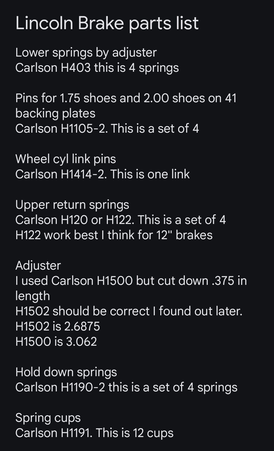

  13. jebbesen
    Joined: Aug 18, 2015
    Posts: 797
    jebbesen
    from Winona, MN
    I'm gonna post this here again just for peoples future reference. These are modern numbers I figured out when doing a few sets of original Lincolns.
