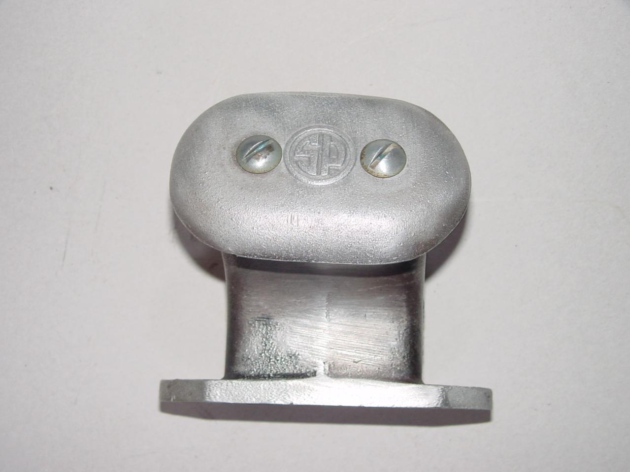

    Satanherself posted this rad find earlier today... some rare SP breathers.
    I know she was curious why these were so big... they measure 5" across... I guess I'm curious too...
    So here I am asking...
    what makes for a good breather...
    what makes for good placement...
    and why?

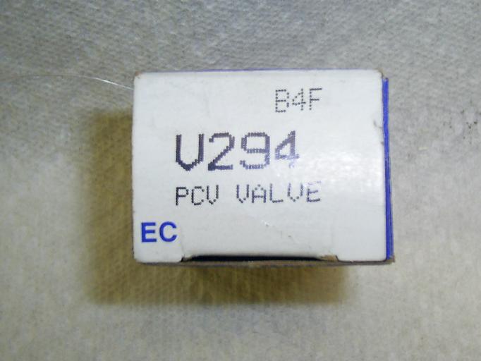

    I took Tommy's advice and installed the breathers on my car like he explaned in his tech post. Here are a couple of pics along with the part number for the PCV valve I used.
    DD
