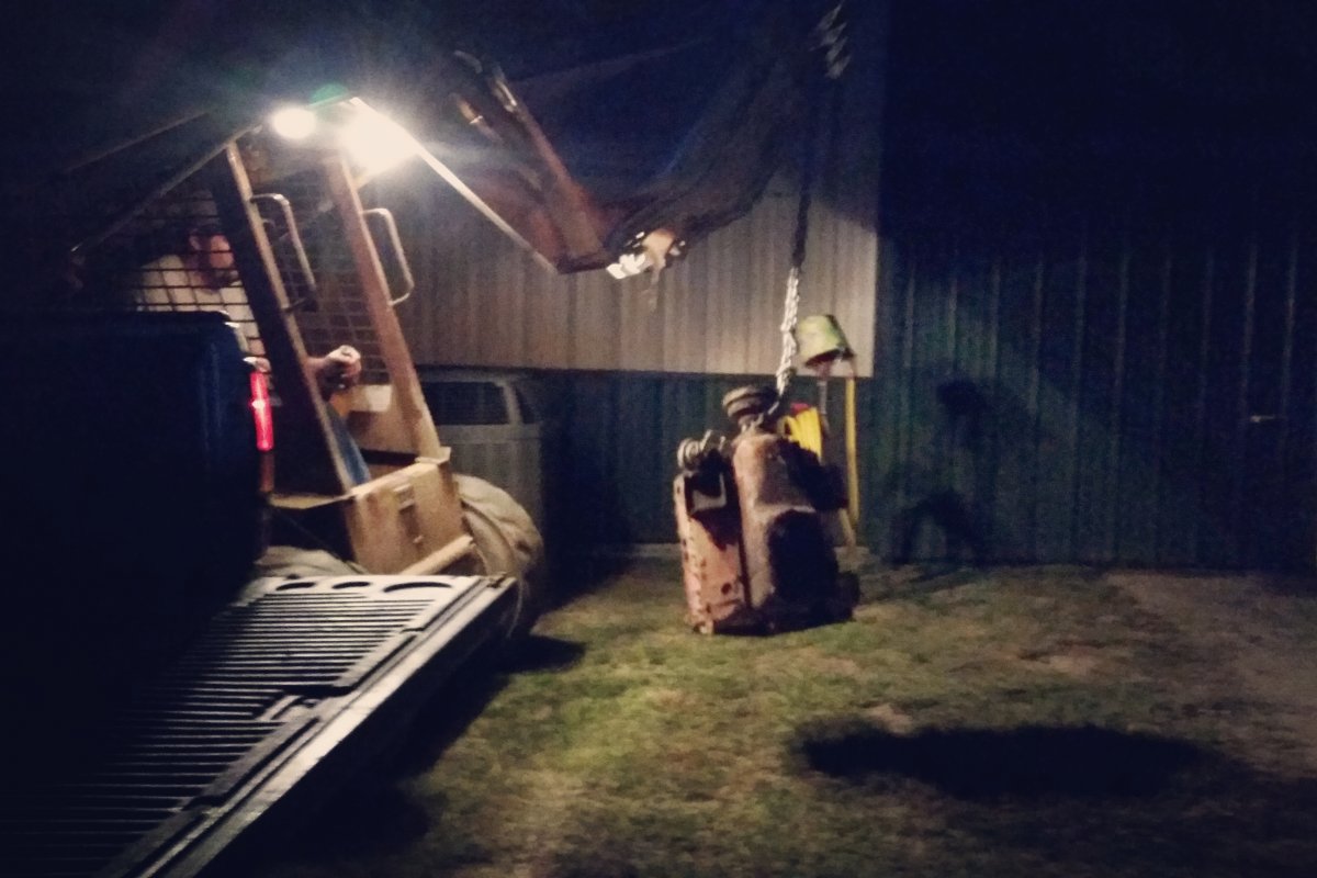

    This story begins by contacting a close friend of mine who thinks he has a 283 laying "in the back 9" somewheres. Low and behold laying in a pickup box is a late 1962 283 with a bed liner that has been covering it for the past 15+ years. No valve covers, no carb or distributor, and surprisingly not locked up. A skid loader and log chain serve as a cherry picker to drag it back to my truck. A deal was struck for $200.

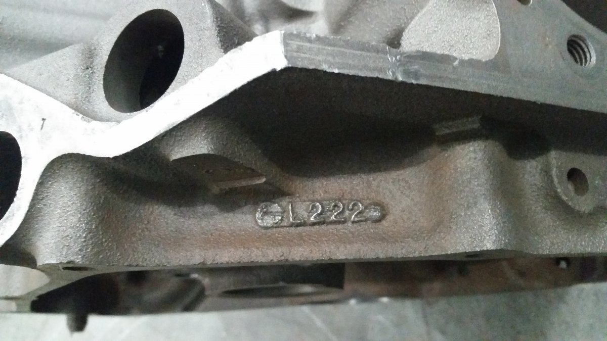

    Casting number
    Date code
    Upon inspection it was all original except for the newer Q-Jet intake manifold. Original GM bearings present and no surprise damage, cherry piece in my book! A trip through my spraywash cabinet got all parts free of paint and grease. Next step was magnaflux testing for cracks. Heads and block were crack free and in great shape! Since this block was getting machined in every aspect I then ran it through my steel shot cabinet to remove rust, scaling, remaining paint, etc to get back down to the raw casting and make it look new again.

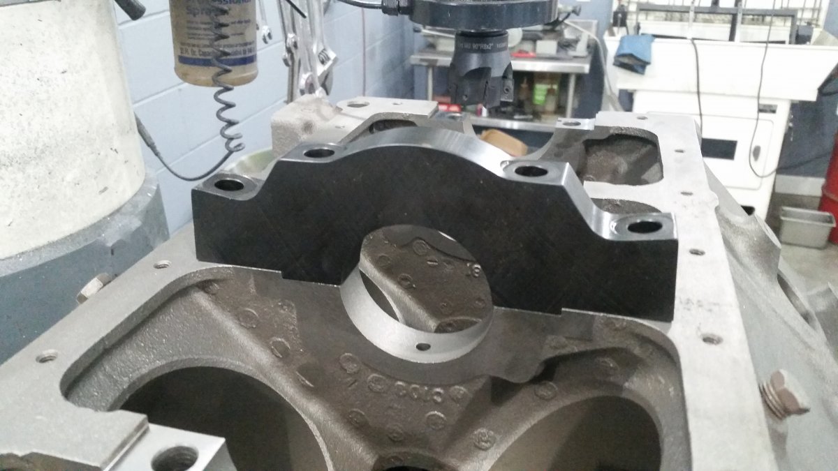

    The first thing I wanted to tackle was installing billet splayed caps in the center 3 mains. Pro-gram Engineering makes a nice splayed billet cap for the small journal 283/327 main size (2.300) and I luckily had a set laying around that I never used. Once I got the block on my mill the setup began.
    I had to toe clamp the block in position and used a dial indicator off the main registers to make sure it was parallel to my mill table before locking down. A 2" face mill was used (after zeroing my mill head in) to reface the main saddles a slight amount so everything would be flat and true.

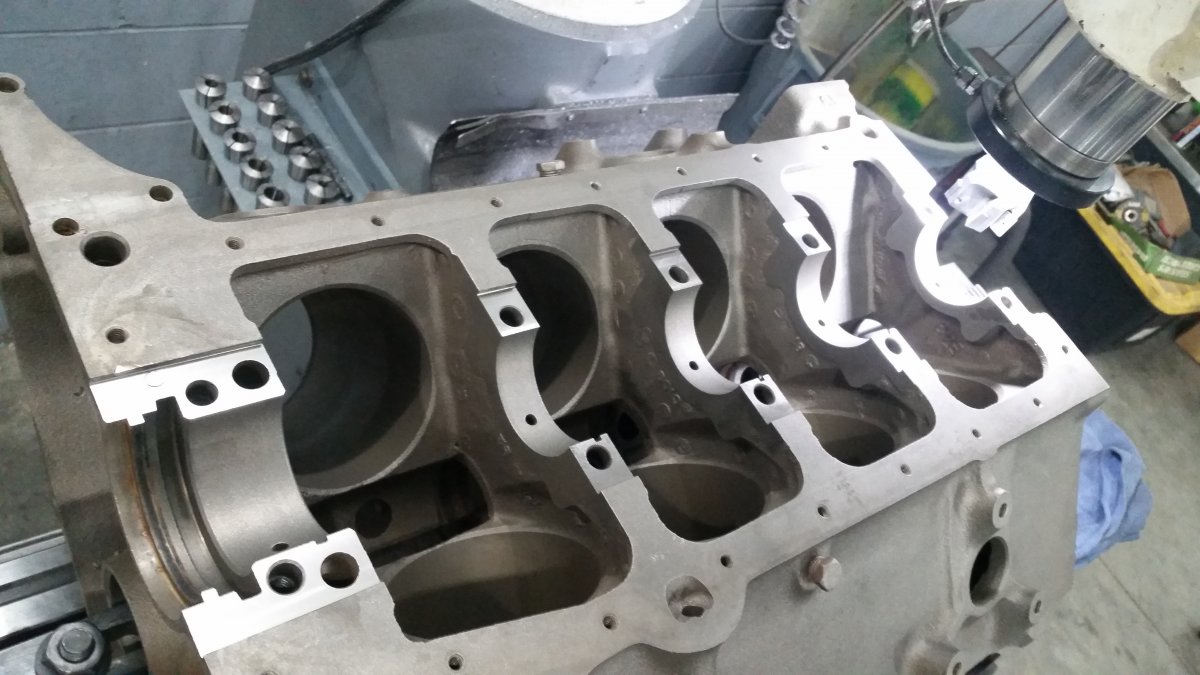

    After accomplishing this and already setup I decided to take some material off the pan rails while I was at it.
    Next step was to sit the caps on and check fitment.
    With a stepped cap like this things can get tricky. Per the instructions there outer step on the cap needs to have a .0015 - .002 air gap. This requires me to grind the lower step on the cap using a cap grinder to reach that spec. The caps are on and off a half dozen times to inch up on it. Once I reached the desired spec it was then time to machine for the outer splayed bolt holes. This requires me to tilt the head out 10° based on the cap design. 10° seems to work best to not drill into water.

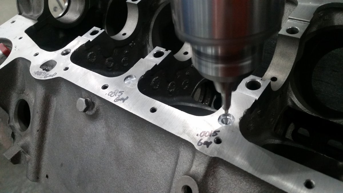

    Spot face with a endmill, center drill for position, drill to depth, and then run a tap down. Wash, rinse, repeat based on the 4.400 bore spacing of the SBC.
    All done with cap installation for now. It will need line bored and honed to size soon.

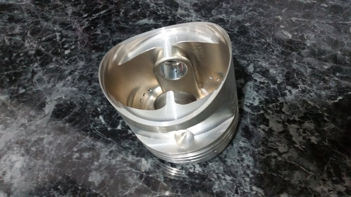

    Next I'll share some of the parts I have acquired for it. Like everyone else I hunt for deals on parts. I stumbled across these Arias pistons for a mere $215 shipped and a set of 10 at that.
    These pistons started this whole process for me actually. They are a 3.935 bore with a 1.885 compression height which is a little goofy. So looking at the math I could build a 292 or a 301. I've decided to go the 301 route in this case (3.935 × 3.100). I will need to offset grind the crank .100 and use the shorter 400 rod which is a 5.565 in length to make these pistons work with the deck height I will have to work with. Odds are I will get some aluminum GRP rods made for the actual length I need.
    So after calling Nick Arias III he informed me these pistons were built around 1976 based on the job number. These were a max dome deal to get as much dome volume as possible in the camel hump style combustion chamber. These have been lightened a slight amount and also have radial gas ports. Pretty trick pieces for their day and I'm ***uming were built for a Modified Production/Eliminator type engine. They have .043, 1/16, 3/16 ring lands in them.

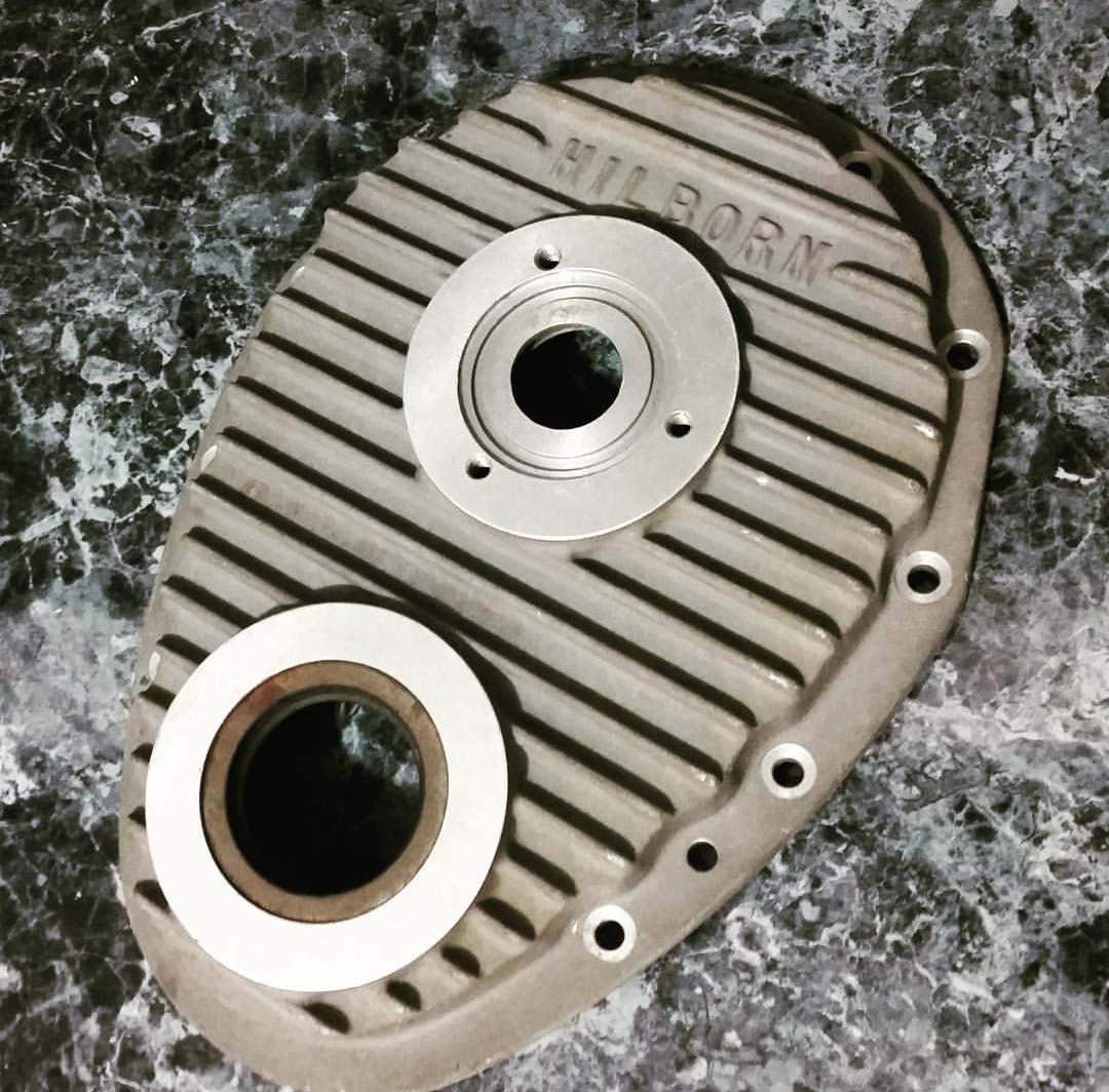

    My next score was a rash of Hilborn items. As a dealer for Hilborn I'm able to refurbish items as needed. I stumbled across this new timing cover that sat on a shelf for 30 years and had a mountain of dust and dirt on it. Quick cleanup in the parts washer and it's good to go after I replace the dry rotted seal.

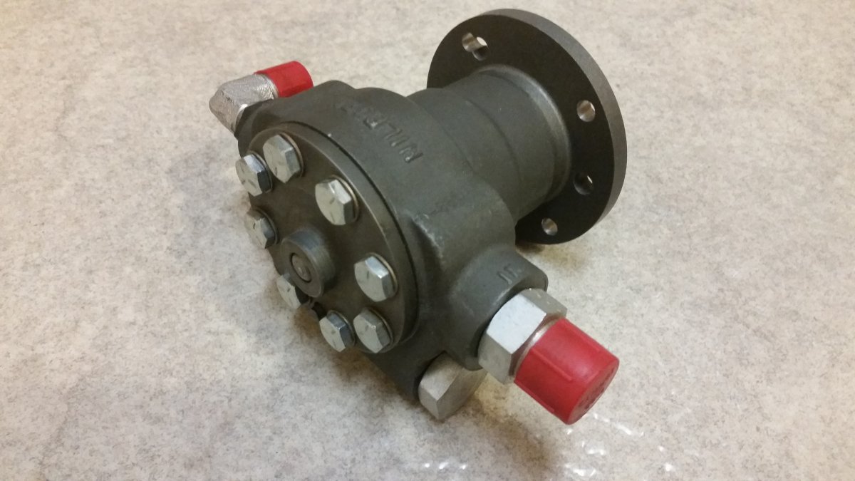

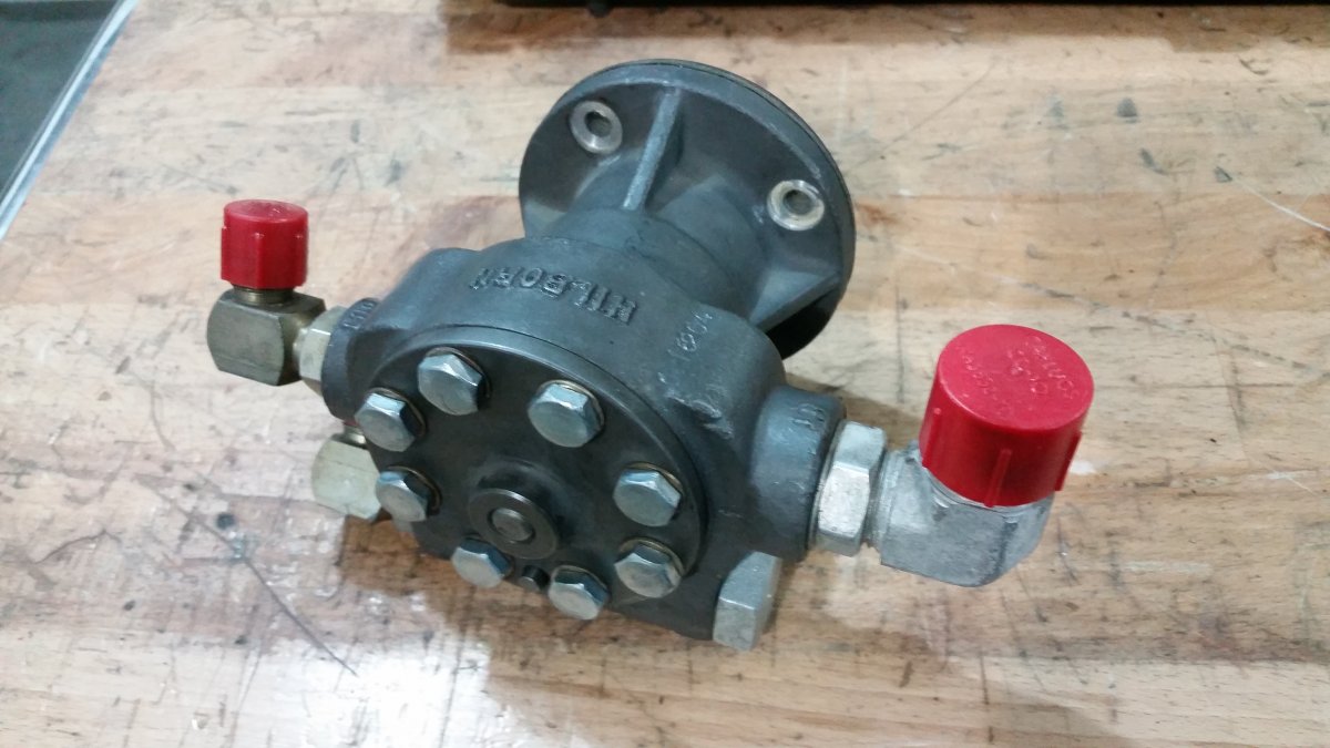

    Then I stubbed across a few "0" Hilborn fuel pumps. One is brand new and the other was used for testing. I took the cover off both and they are cherry!

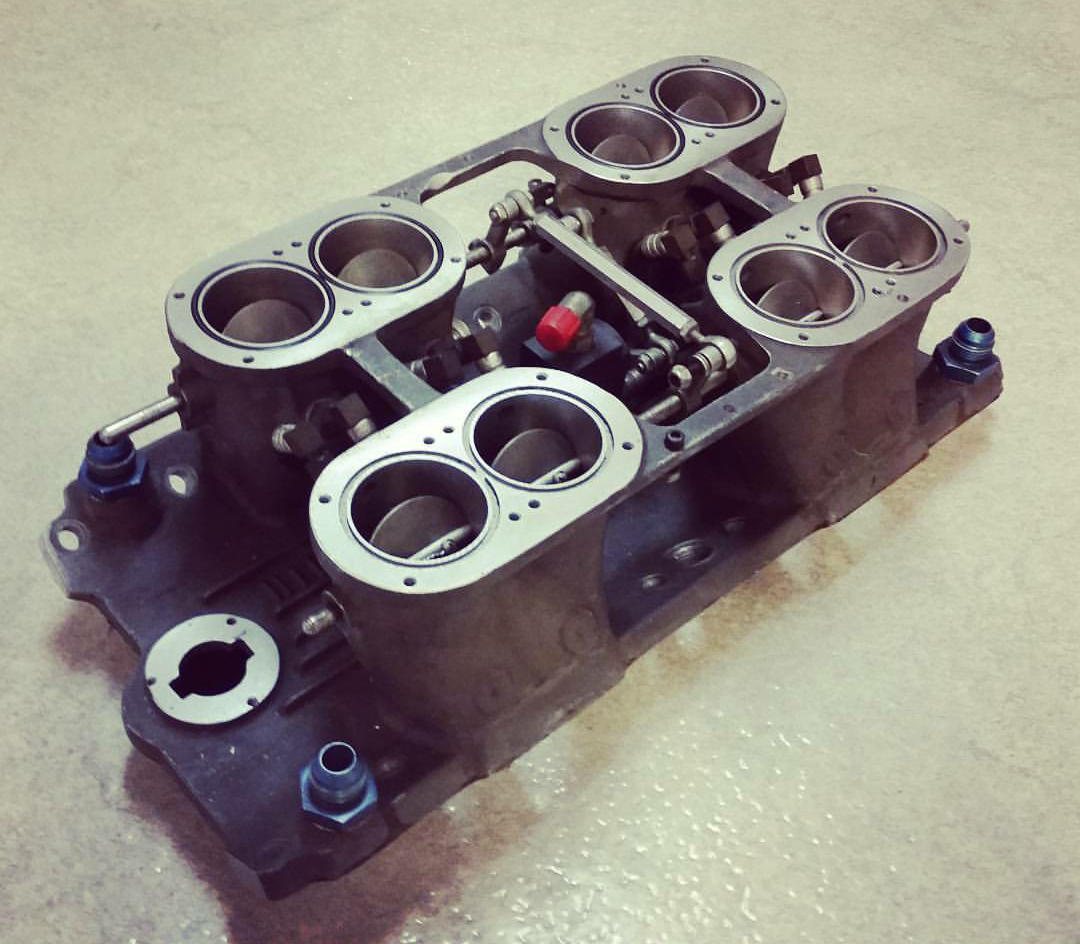

    I scored this Hilborn Injector a few years back. It sat and sat on Ebay forever so I tossed a offer in and won it. It is a Model #265-C-8M and has a serial #121. This makes it the 21st one produced of that model number so it is a very early piece! It is 2-1/16 in size, was O Ringed on the stacks for boost, and originally setup for methanol according to the info I received from Hilborn. Looks like it was built in 1976 as well.

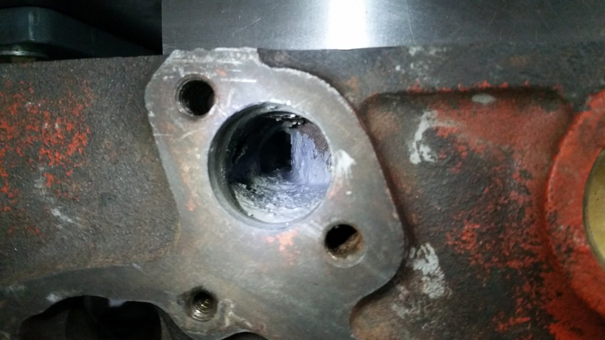

    A few years ago, while building an NHRA Jr. Fuel motor while on the mill. We remover the fuel pump boss and the oil filter attach casting the bosses around the freeze plugs and in the end milled the sides of the block smooth. This block got filled with Hard block and did not run water. But Al said between us we lightened that block 25 pounds before the hard block. It was a bow tie block so it was heaver that a production block to start with. But there are pounds to lose there if you want to.

    When I was gazing at the domed pistons, I noticed that they have a bunch of sharp edges all over the top which create hot spots. Hope you plan on rounding those out.. a CNC mill should do the trick..
    And then gl*** bead the tops..;)

    They will be getting m***aged a bit.
