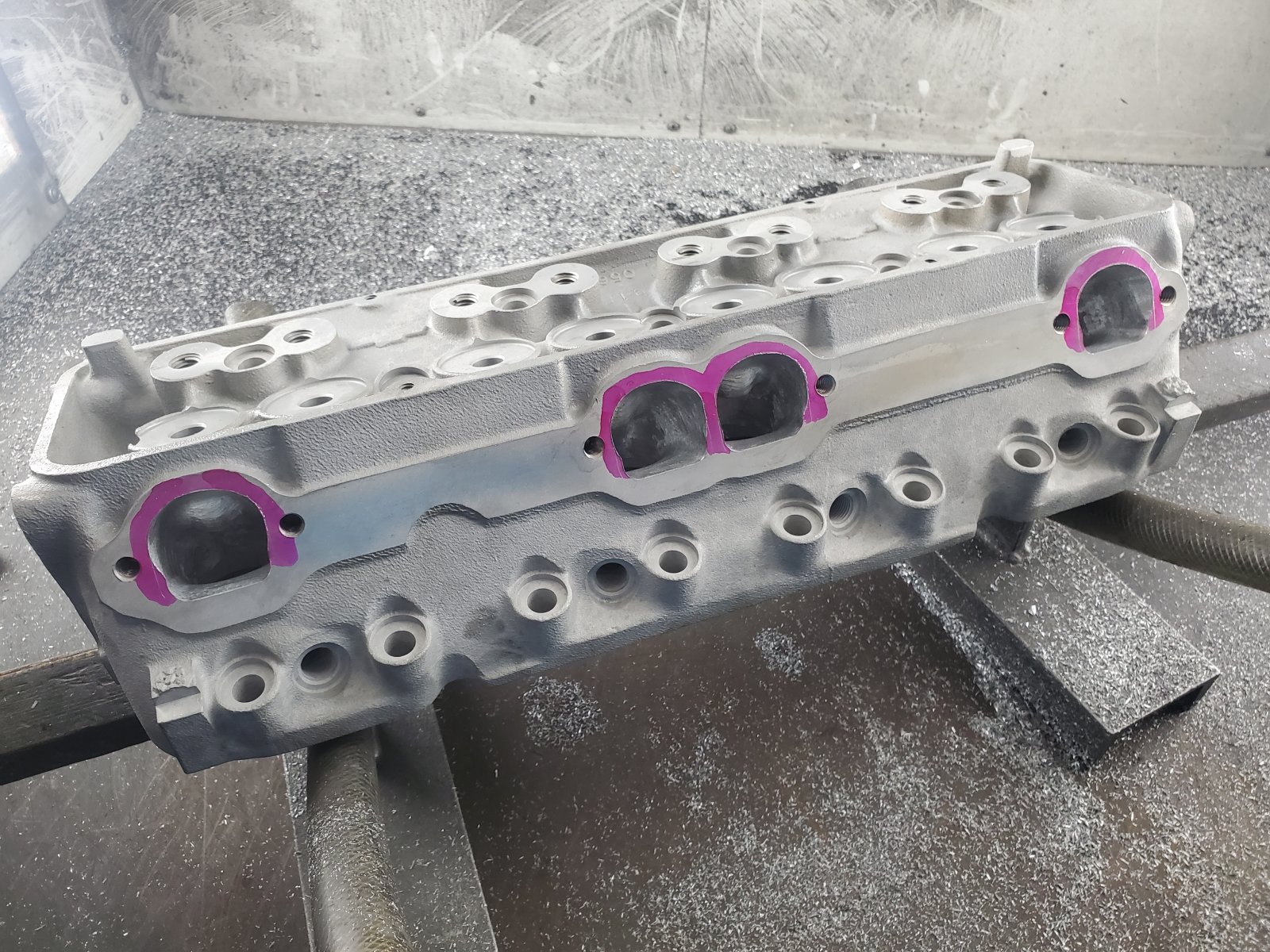

    Well, I'm back and a few things have changed yet again. I stumbled across another set of Bowtie heads that I'd much rather invest my time in, mainly because they are aluminum so potential future repairs will be far easier for me to handle versus cast iron. Who wants to grind on cast iron anyways?
    Scored a set of castings I've been hunting for the last few years and the price tag was finally just right for me. These are Phase 6 #049 aluminum castings that you'll watch me highly modify into a respectable head that will perform to my expectations. The reason why I chose these heads is because how GM delivered them, without seats, guides, pushrod holes drilled, and the spring pads raised .200. This is a standard port location 23° head but not for long!

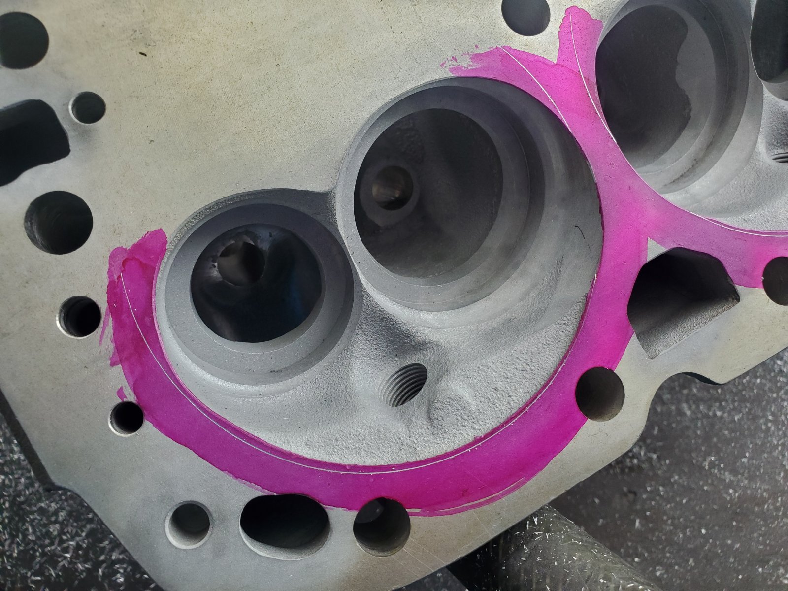

    Here is the standard combustion chamber typical of a "camel hump" head appearance.
    First thing I will do is roll the chamber walls back for airflow reasons.
    Then I have around the spark plug hole to contend with. I will weld this area up and make more like a modern combustion chamber similar to a Dart Pro 1.
    And for those really studying my pictures you will notice I welding in the bowl around the guide boss as well creating a tail on the backside of the guide.
    The next portion I'm tackling is modifying the exhaust ports. The roof will get raised, the floor welded in with a reshaped short side, and lastly a modern oval port exhaust exit.
    Lots of welding, grinding, and thinking outside the box to find ways of improving some old technology. I plan to treat these similarly to how Super Stock heads are being currently done but without all of the rules since I don't have to follow any in my case. I like how these old heads appear on the outside so that I why I sought them out. The intake side will get modified heavily, best to start on the easier stuff first. Anyhow figured I'd update some progress I made a few days ago.
