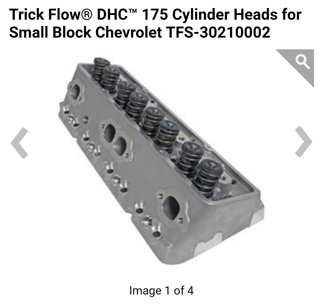

    I'm in the camp of being blown away by those heads... thanks for sharing that link! That opens up many doors of possibilities!

    Another vote for the Camel hump 202's. Yeah, I know the out of the box aluminum heads are ready to rock, but on a mid 60's inspired 283 with vintage Hilborn icing the OEM camels just look the part. Sort of like vintage Halibrands rather than new out of the box wheels on a vintage Rod.
