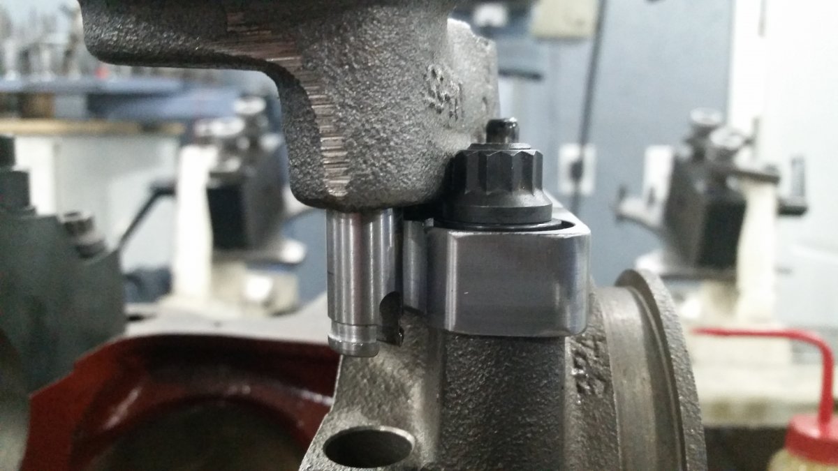

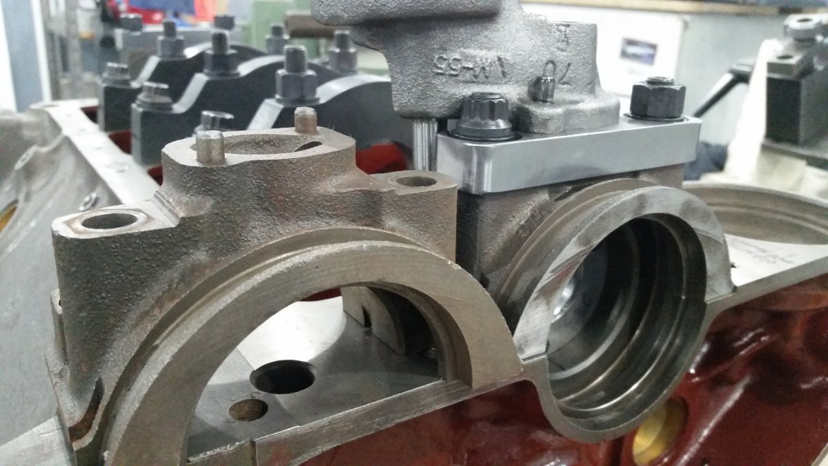

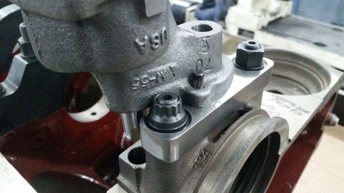

    Not much more to report back yet. Been swamped in my shop trying to finish a bunch of projects. I did want to check oil pump clearance so I did some mockup to see what I was up against.
    With the rear cap strap becoming taller I knew things would be a tight fit.
    It looks like I can remove a very small amount of material from this pump casting but will need to use 12 point nuts for the extra room. I may look at a few other oil pumps and use what fits best. I plan to modify the inside of the pump either way. Still waiting on my cam fixture from BHJ and still need to line hone the block. All for now.

    does this mean a custom intermediate shaft also??
  12. 402BOSSMAN
    Joined: Jul 26, 2015
    Posts: 499
    402BOSSMAN
    Good question, in this case no. Before I started machining the cap I zeroed off of the oil pump pad on the cap and machined down the exact thickness of the strap. This will keep that height in check.

    Pic optics made the hight look different
  14. 402BOSSMAN
    Posts: 499
    402BOSSMAN
    They are at different heights. The register in the block is about .200 lower.

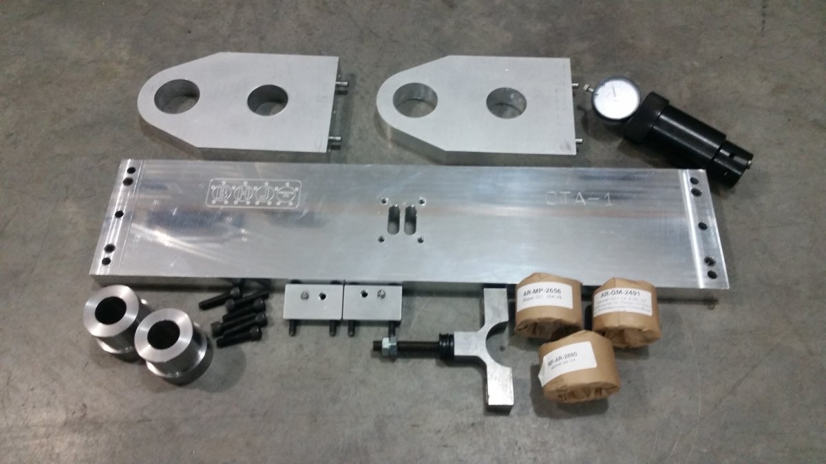

    My BHJ Cam Tru Fixture showed up today. This fixture will put the cam tunnel in the correct location and I can also enlarge the tunnel in the process. Looks like I better get things moving.

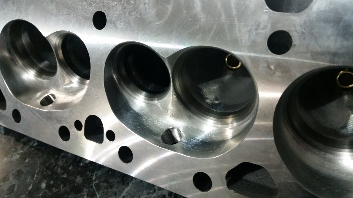

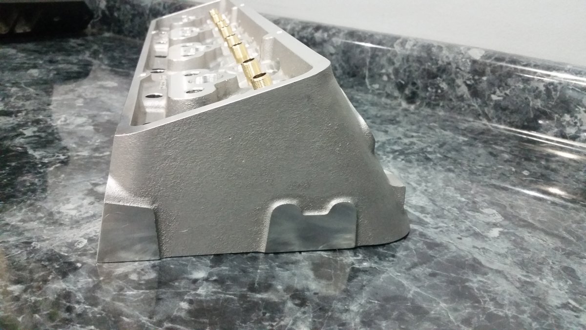

    Well the R&D piece showed up a few days ago. Here are some pictures of the no accessory hole version.
    I decided to use some similar valves to what they would probably supply the heads with to do a baseline flow test (2.02/1.60). Intake valves are not back cut and flow test is using a 4.030 bore and a #1204 radius plate at the entry.
    So overall on the intake side they flow pretty close. I will do the exhaust side at a later date. Here is what is advertised for flow info.

    I started playing with porting the intake side. Right now I'm trying to figure out what the port likes. This design is proving to be tricky as it hasn't responded in the fashion I had hoped but will keep digging until I can figure it out. Right now I'm questioning the chamber (haven't altered it yet) shrouding the valve or the short side radius shape as I've changed it many times so far.
    Stock Intake Bowl
    Ported Intake Bowl
    Comparison
    Intake Port Entry
    More work ahead, to be continued.

    Work on the radius in the floor just before the bowl?
  22. 402BOSSMAN
    Posts: 499
    402BOSSMAN
    Yes. It has a rather tall height or ski jump to it. They added a bunch of material there on the intake and exhaust sides compared to the factory casting. I've lowered it .200 and widened the short side width to control the air speed. It sounds better on my flowbench and also doesn't go into a choke condition where the port backs up like the baseline test. I picked up some airflow but nowhere near where I want to be for my effort. It will take time to figure it out, at least I have 3 other ports to play with.

    What radius are you using in the corners of the ports?
    Isn't there flow to be found there?
    Bowtie Coupe and loudbang like this.

    No flow really to be found, happier airspeed profile however. 3/8 radius usually but haven't measured it yet.
