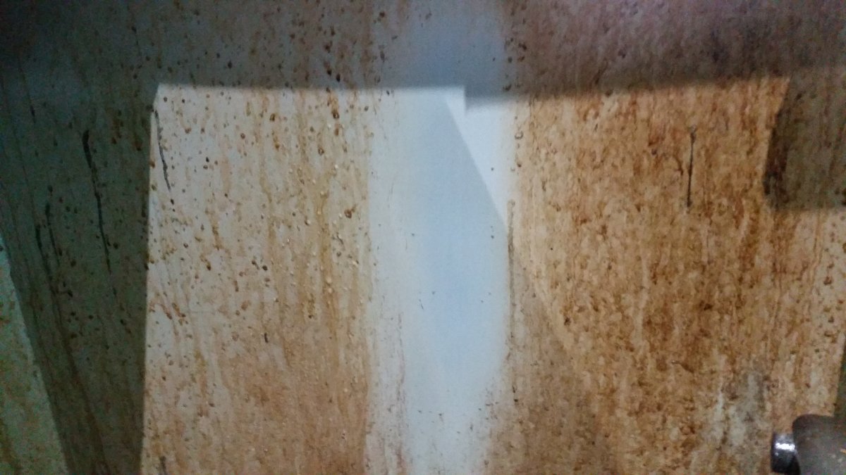

    Sometimes opportunities arise and well I had to jump on it. A fairly large investment but I've been wanting one for awhile, my own line hone. Will certainly be a nice addition for my shop.
    A bit dirty so I spent most of yesterday getting it cleaned up.
    This cleaner is pretty awesome (literally). A scotchbrite pad and this stuff got it looking nice and new again.
    I have a few things to fix and update while it's in this state. Should have it in service in the coming weeks. Hopefully get back to machining this 283 block soon.

    Be sure to wear a mask and gloves. It's some strong stuff. Don't let it sit for long periods of time. It started to bubble some paint.

    Well, finally making some headway again. Got my machine ready to go and loaded the block in. Learning a new machining operation has it's challenges but luckily many machinist friends are around to guide me. I enjoy each operation as they all require different things and a "feel" for the machine. Setup beforehand is the tricky part, the line honing itself isn't very difficult to do. Making the stones wear even is the hardest part.
