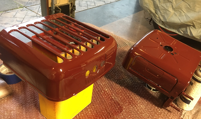

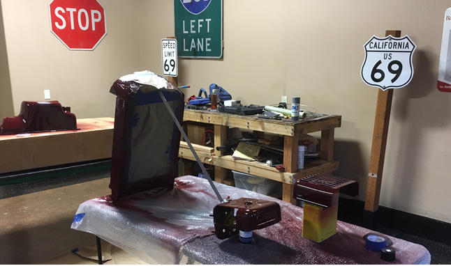

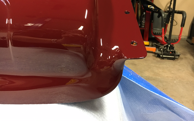

    So today I started off helping a buddy lift his 30 5 window onto his newly boxed frame. Then back home to work on my roadster. I took the grill off the radiator and prepped the radiator for paint. I also prepped the heater box that I built for tech week a couple years ago and the oil pan I painted in recent posts above.
    Clear coat is catalyzed rattle can 2K, nasty stuff, doors open, respirator on. The parts finished nice. I moved everything into my small garage. Covered the little Nova and got it done.
    Radiator sides now match the car. Grille brackets are about to see the chromer.
    Remember the ceramic heater I built for tech week a few tears back, well here it is in color.
    Yeah, that is smooth. Ill re***emble and prepare to reinstall it in the car. I tried to include everything that needed 2K hardened clear coat today. Could not be happier with how the parts turned out.
    Now this is a pretty oil pan
    This is shinier than most Subaru's and Hondas top coat

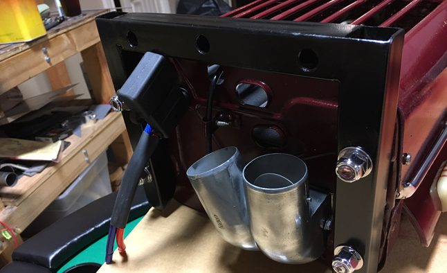

    I didn't get much done today, but progress all the same. I ***embled the heater and wired it all up, ready to mount back under the dash. 3 bolts, power and ground. I ran an isolated circuit to the battery for the heater. It turned out real nice. I jumped it over to the Nova's battery to make sure I wired it correctly.
    Cute, aint it? The control pane was am underdash remote that I moved to the front and frenched it in. The knob on the left is a 3 position pull switch off/low/high, the temp rheostat in the center and the defroster cable (pull defrost, push to close)
    Like my radio, this is just plug and play.
    I welded studs to the back, built that 1 inch bracket it is bolted to, then it bolts to another 1 inch bar that has threads in it, welded to the firewall so there are no holes and it can be removed without anyone knowing it was eer there. I even polished the defroster outlet cuz I could. There is a 30 amp breaker in that housing, I will add a nice little plug on the wires later.

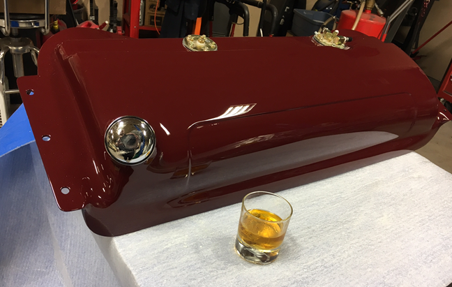

    Not much tonite as I had a late appointment. Tank polished and going in the frame tomorrow night after work.
    You can kinda see the brackets I welded in to adapt the 32 tank to my 34 frame. they are smooth and look legit. I wish someone would give me the money for the hours I spent on them.
    If they did I could buy more Jameson Black Barrel. Tasty aperitif.

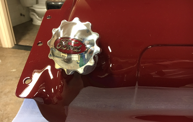

    Not sure on this cap. I bought it a while back because it matched the fuel filter and radiator reservoir. I had a ford emblem that I thought would fit my grill but it was a truck emblem (too large) and rather than returning it, I cut the mounting post off the back and JB welded it to the gas cap. The curvature was a match, the color is spot on, I may run it, after all it is one of a kind.
    Thoughts, opinions, offers?
  7. I'll pat you on the back for the tank mod !
    I like the gas cap, but you're going to gave to look at on the complete car to see if it matches.
    Looks Art Deco fire engine-ish

    Dude, the tank mod was a seat of the pants deal. I bolted steel to the frame, sat the tank on the "brackets", applied heat and hammer, tacked, bent, cursed, drank, drank, added steel, added swear words I had not thought of yet, added another spool of MIG wire and that was the result. I had to fill and re-drill the frame holes to move the tank toward the front of the car to clear the spreader bar and license plate I made. 9 out of 10 would not even notice or pay attention. The really cool part is the tunnel the mod created for the tail pipes to run through underneath. But that is fodder for another day.
    Sancho, tb33anda3rd and loudbang like this.
  9. Around here we call a day with a job like that Tuesday :D
    When it looks good and you can't tell you did anything and kills more birds ,,, that's the sign of a perfectionist at work and a job well done.

    You're making me look bad! :p The heater is drop-dead gorgeous. I like the gas cap, not sure if looks "right" on your car, a bit fire-truck-ish. You'll have to stand back and stare at it when the tank is on to see if it fits the style. Amazing work, as usual!
    Bandit Billy and loudbang like this.
  12. loudbang
    Posts: 40,346
    Mill the "bumps" off the outer edge then it will look better.

    Actually I think that he should keep the bumps.
    That way when his fingers are all swollen and arthritic and sore from all the polishing he will still be able to get the gas cap off after he opens a bottle of this. ;) :D
    Notice the similarities in the cap design ? :D:D

    Because this one is ceramic it can be mounted in any position. I just made sheet metal ducting to direct the air flow. Important thing is to allow the intake to be free of restriction. Before I mounted it in the heater box I took it to the golf course and took along a charged car battery I had lying around. The cart was enclosed and it got toasty warm in there fast. Battery went dead in about an hour and a half running the heater on low continuously. Successful test I thought.
