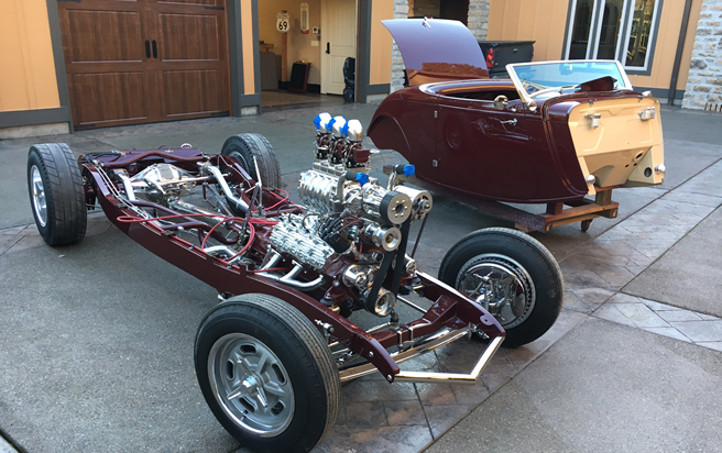

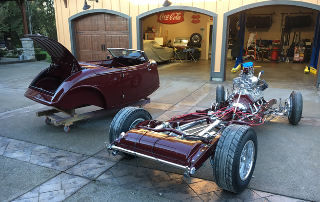

    I got a few more things done today. I made the harnesses for the pump and sender, added a quick connect to each (one male, one female so I know how to plug them back in). I also added the frame webbing, secured the brake line over the QC that needed reinforcing, then it was out with the frame and move the body to the lift for final prep before mounting the two.
    The two pieces met briefly in the driveway. They'll get to know each other more intimately later.
    I ended the weekend with the body off the cart and on the lift. A phone call to summit in the morning for a few parts and with any luck I will mate these halves up next weekend.

  23. GordonC
    Joined: Mar 6, 2006
    Posts: 3,464
    GordonC
    Bandit Billy your build is coming out awesome but I have to tell you I am sporting serious wood over your driveway and garage set up! Man that is an awesome shop set up! You win the best background in a photo contest hands down!

    I live in a subdivision with some serious rules on what you can build, basically no shops. But they forgot to include how many garages I can have. :cool:
