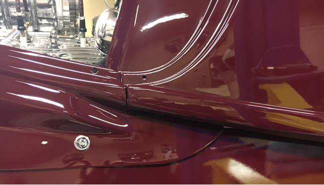

    If you are familiar with 34 ford inners, you know there is a square notch at the bottom and you know how far back they go. I filled all of the holed on the top, lengthened them and filled the notch on both sides. You cant tell, just stuff no one will ever really notice.
    and right

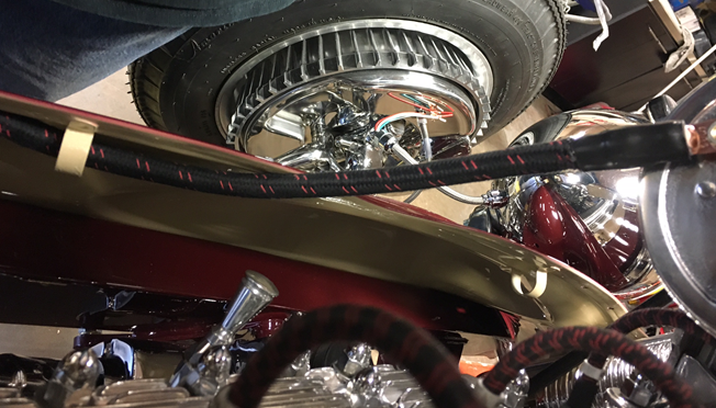

    I also added some straps inside the inner fenders to secure the wiring harness, here is the alt cable running through one of them

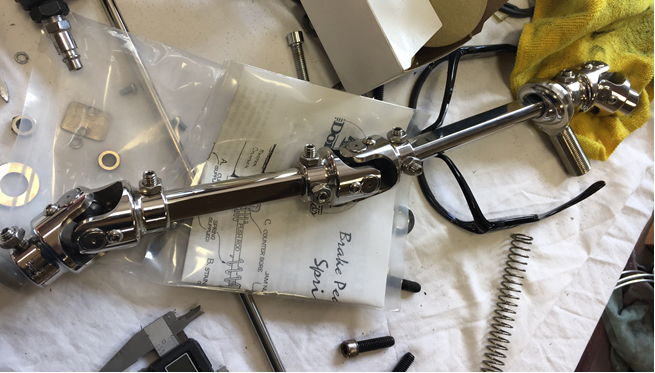

    I also finished up the steering link. Pretty aint it? A lot of SS in this p***age.
