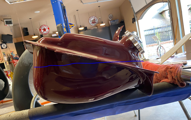

    It has been just over a year since my last update on this thread. Driving the car has been a lot of fun but not without an issue or three to iron out. The most major of which is the fuel capacity of my nifty 32 fuel tank. To make it fit the 34 frame I widened the brackets, moved the filler lower on the tank to clear the body and of course I had to notch the tank for the QC. The result was about 8 gallons of gas, 5 if you didn't want it to leak when you took right hand corners or belted it off the light.
    The blue line represents maximum capacity., as you can see I lost half the tank
    Even more when you consider the QC notch in the back.
    So it was back to the drawing board. After weighing my options it was clear the tank was going to be going inside the trunk so I had Rock Valley Custom tanks build a SS 17 gallon tank. It used my old in tank pump i just had to have their pickup ***embly and a tube style sending unit.

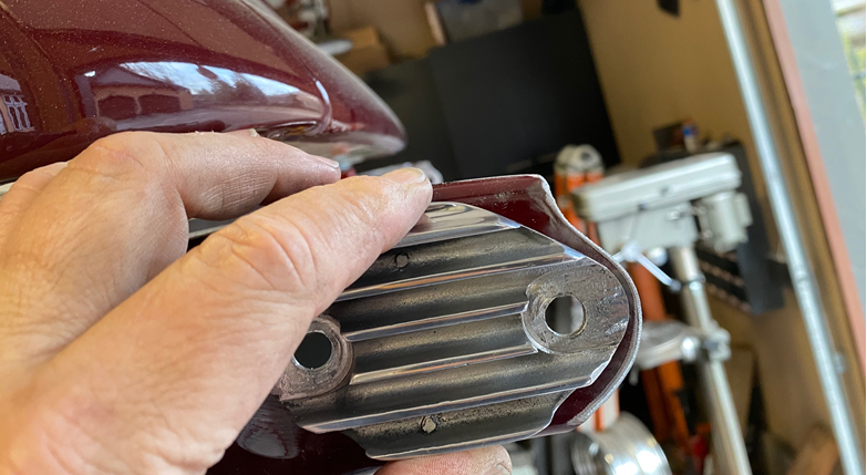

    You can see from the rear the backing plate i made to hold the Lucas plate lamp/reverse light and the plate brackets.
    The engine turning is a nice add if you happen to be under my car looking about. The wiring leaves the backing plate and enters the trunk through the hole where the sending unit used to run.
    And the "end" result
    I like the plate mount as it appears to float below the trunk floor, plus it was a no cost add since it was all repurposed.

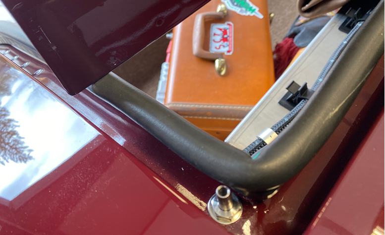

    Amazon brought me a piece I was waiting for today A 1/4" barbed bulkhead fitting, chrome of course. I drilled the trunk jamb and plumbed it to the roll over valve that came with the tank.
    It fits nicely in the rain gutter
    Venting to the atmosphere easily
    Need some leather back here, but check this off the list.

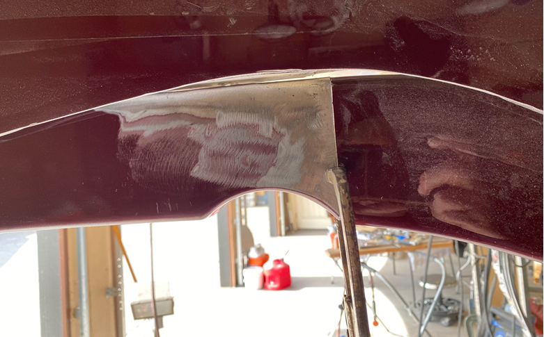

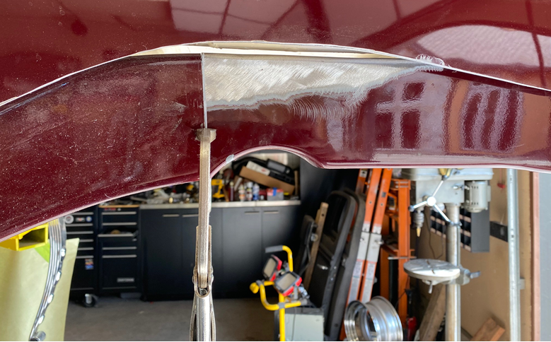

    I peeled back the boxing plate a bit where i need to weld the frame back together
    I still need to strip all of the boxing plates from the rear frame horns but that is a project for tonight. I skinned up the floor a little but i have to repaint a bit anyway and hope to have the color back on by the end of the weekend. I want the tan painted before i replace the frame.

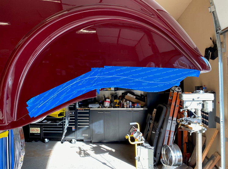

    Next up was to raise her skirt! The frame will be parallel to the trunk floor when I am finished so those inner fenders need t******* or they would be lower than the frame. And I needed to get to the frame for cutting, welding and painting.
    So I marked it up and cut it off
    Repeat when necessary
    They came off pretty clean, very little paint work required here, basically just the exposed edge needs color and clear. It will test your metal (pun intended) to take a wheel to a well painted car.

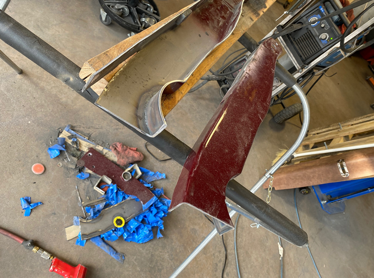

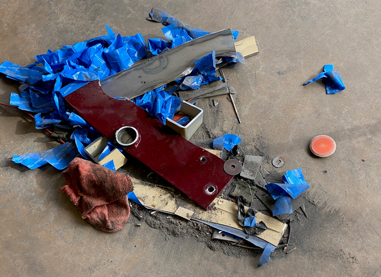

    Last night I strippd the boxing plates, these are more fun to add rather then subtract BTW.
    That's the ever growing pile of steel (granular and larger pieces).

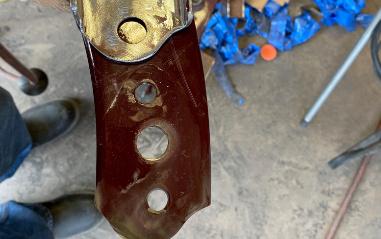

    Don't need gas tank mounting holes any longer since the tank is inside the trunk so...
    Gone

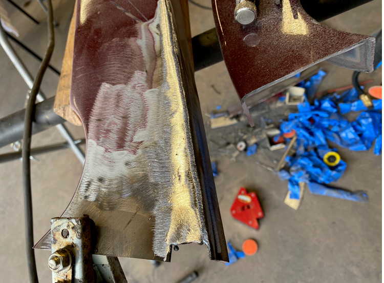

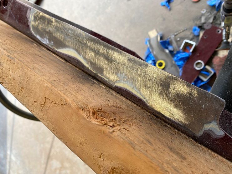

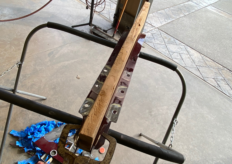

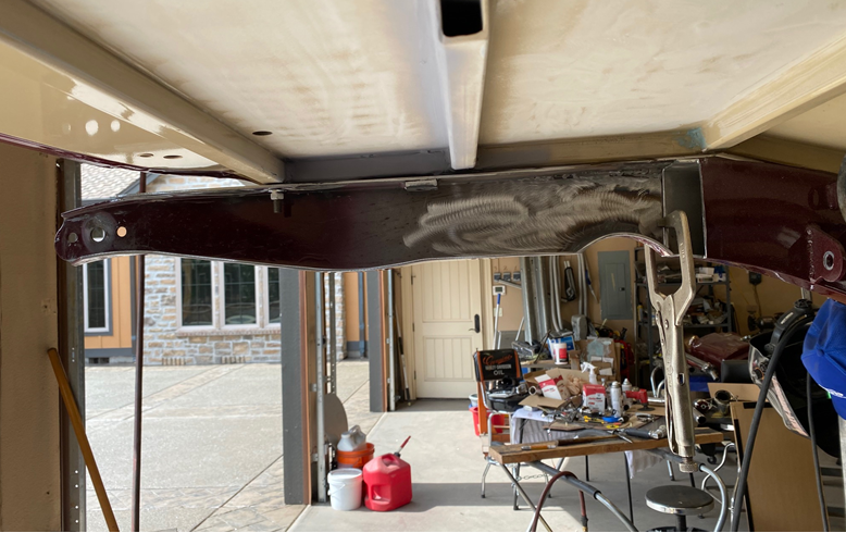

    Then it was on to flattening the tops of the rails so they can go back on. That is a lot more wedge than I expected.
    I will have to trim the bottom up about a quarter or 3/8ths of an inch to meet the rail under the car.
    You can see there is quite a hump on them. I cut them off at the apex in the top of the frame so the rest of the curve has to go away. I used the sacrificial steel from the box plating to fill the gap. I didnt fill it to the end since i have to trim a lot of that off to fit the rails back on.
    I was tired of cutting and welding for one after work session so that means I still have the other side to do. Then on to cutting the rails to fit and making those upper shock brackets.

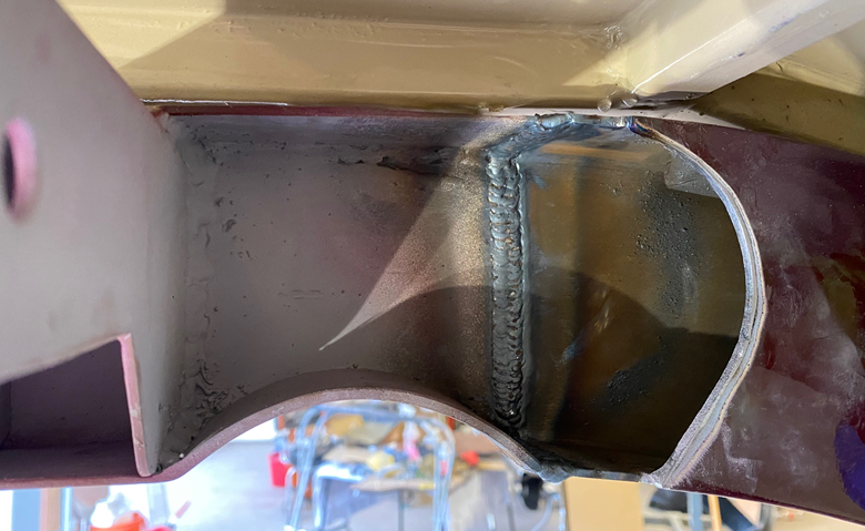

    I started by cutting the frame rails to fit
    They are tight and very right
    And inside

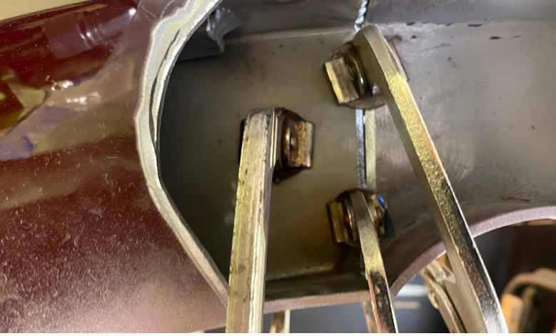

    I have yet to v the joint in anticipation of welding the seam up. But it is tight. You can see the C notch remains and you can see the flat upper rail from previous posts. I welded in studs at the rear to mount the body to the frame.
    This helps with both body/frame rigidity and the task of re-***embling all of this. I will add a frame pad between the body and frame on that new rear mount.

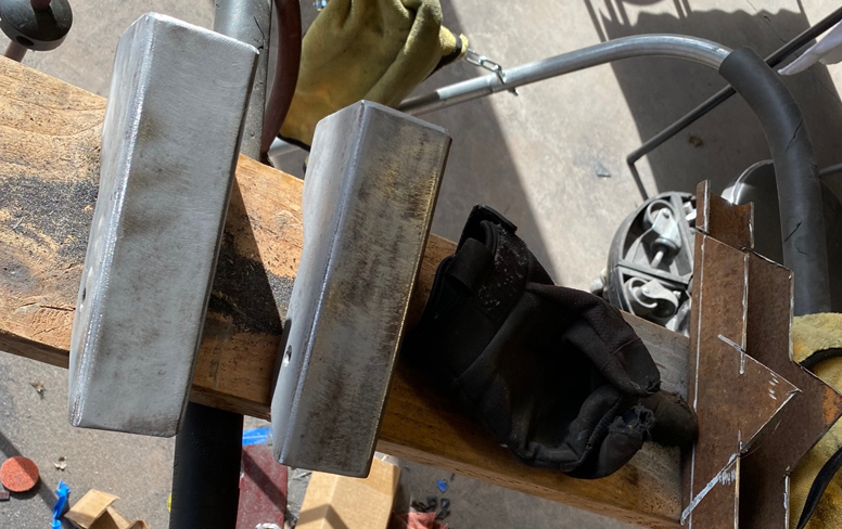

    These are the upper shock mounts I cut out of a piece of steel 2X4 as previously mentioned
    This is them welded into the frame, right side
    and left
    and from the rear. Looking tidy with no crossmember and ample exhaust room.

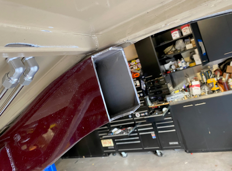

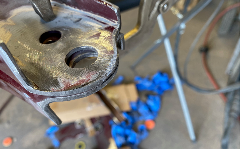

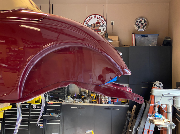

    The last thing before tip off was to shorten the frame horns a bit. I tried the spreader bar in the original holes and it was too long visually. The shortest holes were a no go as I didn't have room to mount the license plate. Like Goldilocks', the middle hole was the money shot. So I used one rail as a pattern to plasma cut the other.
    Picture perfect cuts just a bit shorter and matched side to side
    Now the rear hole used to be the center hole, it was a bit larger to allow for wire p***age when the tail lights used to be frame mounted. They are well covered by the outer ribbed plates that will once again adorn the frame rails.
    Next up, other than the Championship game Monday night featuring Gonzaga and Baylor, is to paint the floor in the morning both base and clear and then work on welding in the rails. Then finish painting of the frame and reinstallation of the rear end.

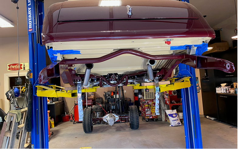

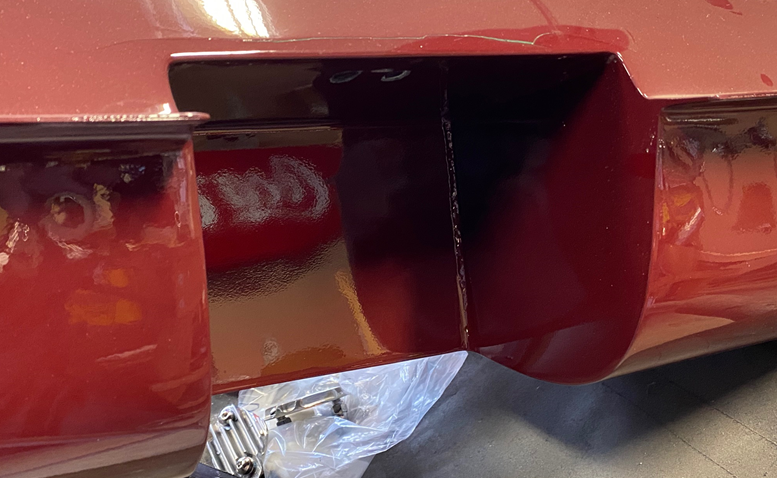

    This is going to look like it was planned from the start. Only my hairdresser (and the HAMB) will know for sure.

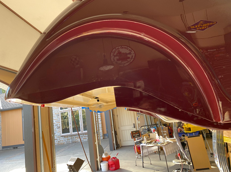

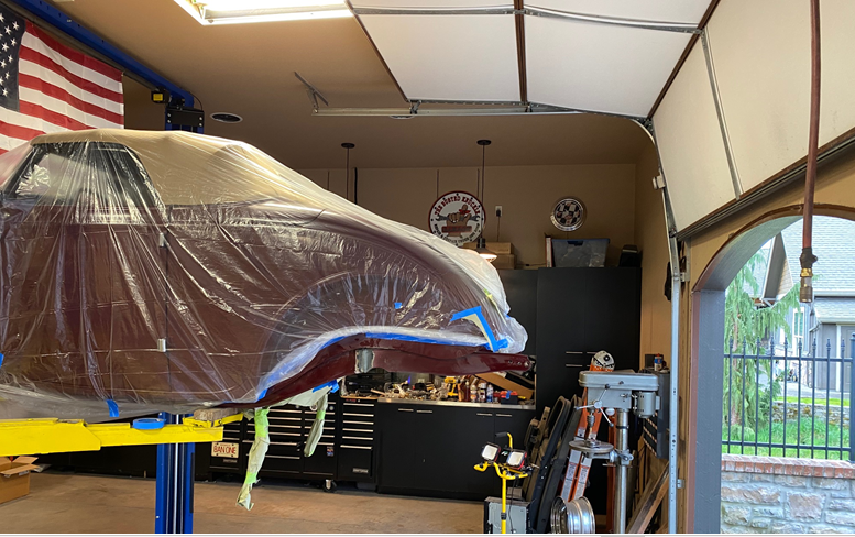

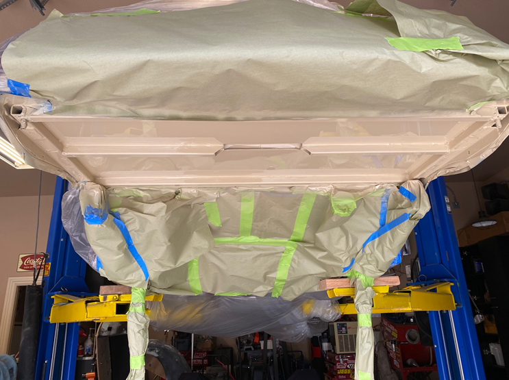

    Looks like a giant shake and bake bag. But that should keep he clean during the painting.
    Floor tan color is on and clear coated.

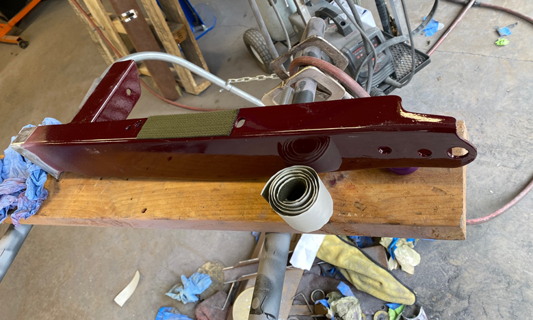

    I stripped what was left of the paint form the frame horns in preparation of painting them. I have to paint the top of the rail because once on the car I won't be able to do so. I will leave the weld area bare on top and airbrush that spot back in. The inside, faces and bottoms will get paint after they are welded back on.
    I didn't get a photo but i did add a fish tail to the end of the boxing plate so it wasnt so abrupt. Looks nicer.
    Go Zags! Game time is 6:20 locally. No car work tonight.

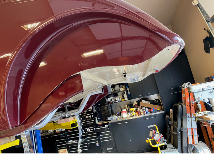

    A little color, clear and frame webbing where I cannot reach once reattached then onto the car for welding . .
    Gaps as tight as as I am able, beveled and clean
    And s***ched back in place.. Note new cuts to the boxing plates, an improvement over just a straight cut.
    upload_2021-4-7_23-44-5.png k
    Welded both back and front
    Now, doesn't that look better?
    Frame bobbed and tucked, now to finish and paint then re***emble. Looks like it was meant to me like this all along, right?
    Tim_with_a_T, pprather, X38 and 12 others like this.
