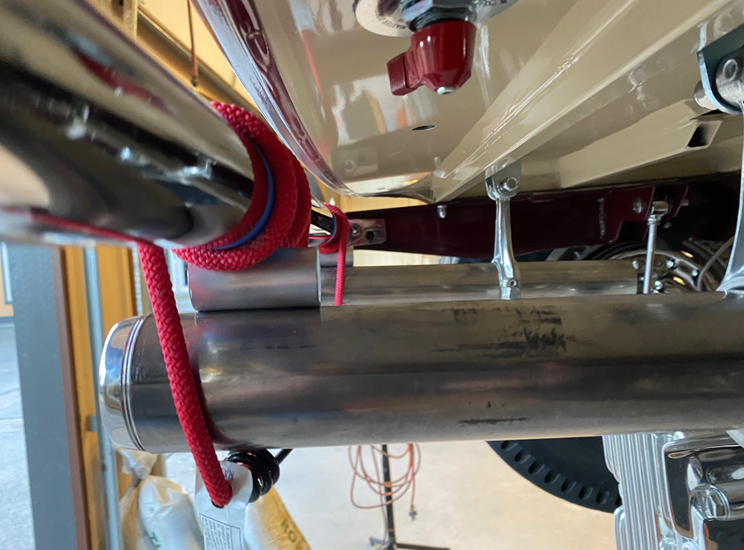

  5. Bandit Billy
    Joined: Sep 16, 2014
    Posts: 15,971
    Bandit Billy

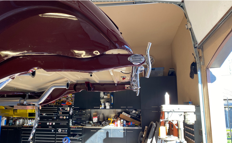

    Paint/clear applied. Spreader welded back together...seriously? Don't chop up stuff up until you sober up! That should be on a tee shirt.
    Not easy painting two colors under a completed car but I found a way evidently. It did require a lot of masking tape, paper, Crown Royal and patience.
    That's a lot of shiny in a tight space.
    For the moment the plate is mounted in the center of the spreader bar.
    There was already a hole there for the wiring and initial plans are to run the exhaust pipes on either side of the plate frame. I need to reinstall the QC before making final plans. But I do like the look so far. Note I retained the nerf bars.
    I will put the rear end back under the car tomorrow and try to figure out this puzzle. I still need to add tail lights to this mess. All this over a few gallons of gas!!! Oh Veh!

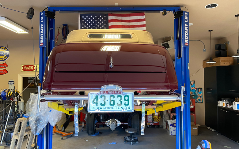

    I escaped a bit early from the office and came home to wrench a bit. I stuffed the rear end back under the car. I like the new upper shock mounts.
    I am not a car painter but I doubt many shops would try to paint two colors in such a small space. I pulled it off and it looks good even up close. I used a ton of masking tape and paper!

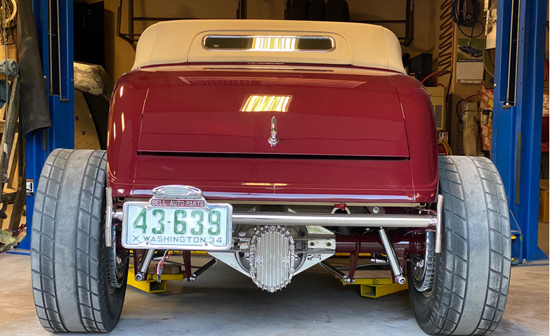

    Back on all fours, I tried the plate in the center
    and over on the left
    I like the center. But the plate is too low. This mount won't work any higher so I need to do some customizing. I want the plate bottom at the bottom of the spreader.
    Then the twice pipes should be easy enough to route and look more planned. The plate will also lean back a bit more, it is too flat right now. Still need to work on tail lights. I can see why guys add them to the ends of the spreader bar. There isn't a lot of options. Hmmmm
    My original thought was to hang the pipes and see if the tail lights would look good at the same height. I think I will start with the pipes.

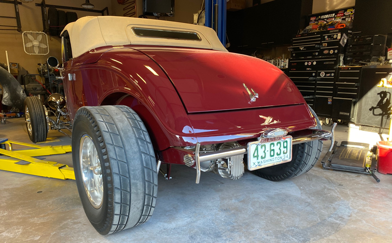

    All done! I just need to carry a roll of tape in case it rains.

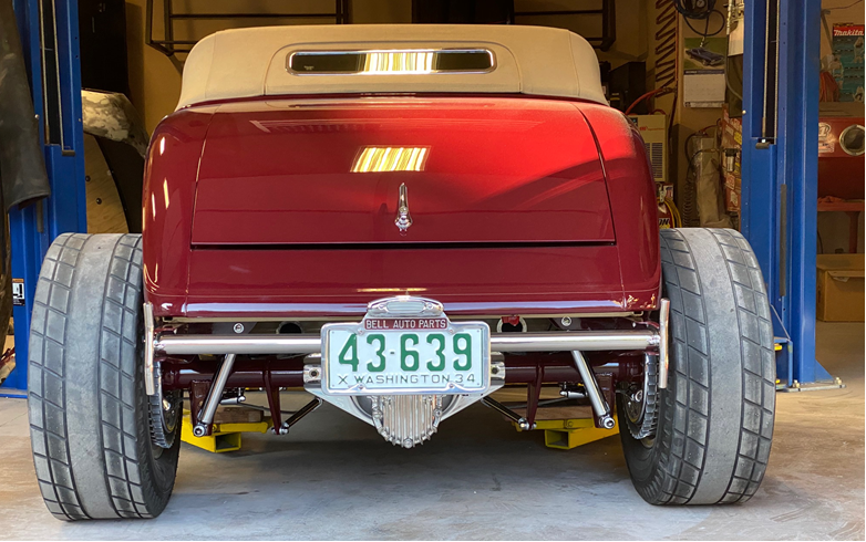

    License plate looks at home up high, exhaust flaking it on either side.

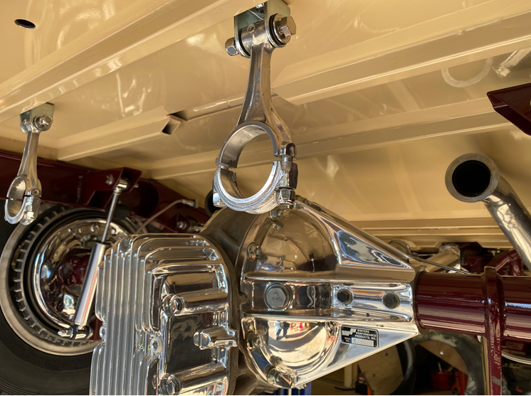

    I bought these neat little brackets from Summit, they are actually panhard brackets but I have repurposed them.
    The perfect size to hold the 8BA connecting rod exhaust hangers.

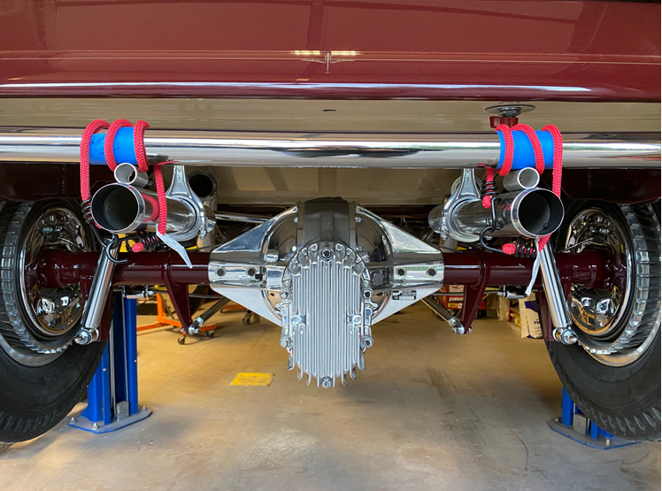

    I used some 1" tube to gap them from the spreader bar for now. I will lock them in place before fabricating the tail pipes to make sure they don't move. I am thinking taking a 2x4, drilling two 2.25" holes in it 11.25" apart, 1" space at the top and secure it to the spreader to make sure they stay put. But this is where I like them.
    That puts the pipes dead level with the trunk floor
    The pipes are s**** pieces I had laying around from making my roaster show display a few years back. I tend to use 2.25" on everything including my 41 PU i am building. That way you have odds and ends for other jobs. 304 SS, it will polish up nice. I also picked up four 45 degree mandrel bends out of the same material. I have welding and polishing in store for my weekend.
    I will run them just past the spreader bar but not as far as the nerf bars on the ends.
    My exhaust inserts from the original tail pipes will complete the install then it is on to the license plate bracket (sans masking tape) and a couple of tail lights that require alteration.
  25. atch
    Joined: Sep 3, 2002
    Posts: 6,393
    atch
    Awww, c'mon; that blue is purdy and provides a nice contrast...
    loudbang and Bandit Billy like this.
  26. flatheadpete
    Joined: Oct 29, 2003
    Posts: 10,669
    flatheadpete
    from Burton, MI
    Just when I thought this car couldn't get better....Great job on cleaning up what was already very well done!

  28. Jim Bouchard
    Joined: Mar 2, 2011
    Posts: 1,314
    Jim Bouchard
    The license plate is perfect right there and the pipes flanking it looks great.
    Nothing is looking out of place.
    Great job!!
  29. Bandit Billy
    Posts: 15,971
    Bandit Billy
    While it did make for an easy method of mocking up, I am not overly attached to the blue. Perhaps shiny silver exhaust bandage tape?
    Nice compliment buddy. It is a proper place to house a blown flathead. Now it is equally aggressive from the back.
    The entire system is hung with those rods that i cut down and had ceramic coated over at Russ Meeks place. I love 'em. Always mounted "ford" emblem out.
    Thanks! Now I have to figure out how to mount the tail lights (small necessity). The original mount would have them directly behind the spreader bar and nerf. They need to move inboard and down below the spreader. I am thinking once the pipes are welded in place, mounting the tail lights along side them would look cool?
