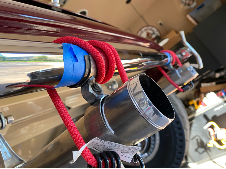

    I came up with a better idea than the 2X4 to position the tail pipes (mainly because I didnt have a 2.25" hole saw), I sliced a 2" pipe to conform to the 1.75" spreader bar and a 2.5" pipe to hold the 2.25" pipes. I welded them together with a 1" nut and tweaked them a bit tighter with a pair of channel locks. I attached with double sided tape to the spreader (over the masking tape for easier removal.
    Still utilizing the bungie cords for tension but the pipes are locked into position. The white mark is for easy reference for tip length. I ended up with a bit more than an inch due to the tape and the wall on the pipe I cut but this is close enough for government work and that is good enough for me.
    That done it was time to slice up some pipe. I don't have a chop saw so it was portaband time. Mine is mounted to a table with a foot control so that part is nice and I used the HAMB approved "hose clamp" method for cut guides.
    They will need a little clean up but not too bad for a garage hack. I used four 45 degree mandrel bends plus a section of straight pipe.
    The mock up, yes more blue tape!
    I tacked the SS v-band adapters to the pipes so I could mock the system up. I will weld them in place on the bench once I tack the rest of the joints on the car. Other than the weld at the v-bands I have one weld in the open field on each pipe (blue tape) and the last welds (for the tips) is under the connecting rod pipe hangers so they will be hidden. Also the flathead rods are slightly larger than the pipes, so I will keep my weld a bit high under the rod cap (not ground all the way down) to snug things up.
    Good axle clearance, the bump stops in the C notch allow for 4.5" travel from this "hanging" position. The shocks will reach their limits before the exhaust finds the axle.
    Next up is welding up the joints and then polishing the pipes.
    I am using tri-mix gas and .30 stainless wire in my Millermatic 220 MIG. This is my first time welding SS so I plan on spending some time practicing on the s****s cuts I have left over. I will be back Saturday with the results then it is onto the tail lights and plate hanger. Almost done!

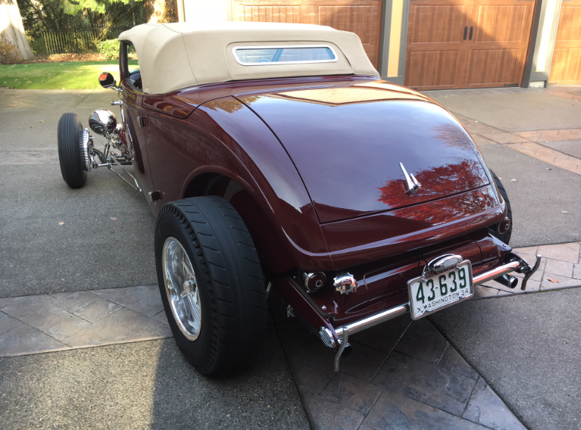

    Here's the before.
    And the after. Most people wouldn't even notice. Same nerfs, same spreader, same plate frame, same exhaust bezels, same but entirely different.

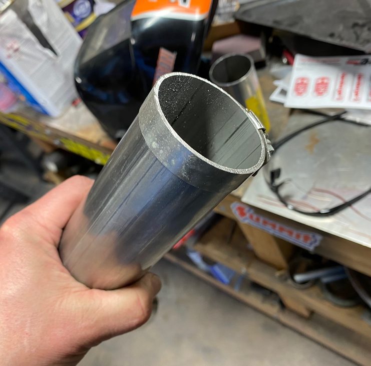

    I have had good luck making my own conical seals. Flare some copper tube, and then cut the flare off.

    I couldn't seal up one of the fittings, just continued weeping so I followed your advice. I didn't have any copper but I did have some 3/8th (-6AN) aluminium (spell check allowed that Queen's English spelling surprisingly). So I flared a piece,
    chopped it off (the paint stick was so I could get a straight cut due to the flare),
    cleaned it up with a file and installed. I had to put the fitting down a little tighter than normal as this material did not crush as easy as store bought seals but no leaks. Thanks for the tip @****** !
    Being a novice I made a double flare the first time and it wouldn't crush at all. Second attempt was the money shot, set the tubing in the die at the 37 flare rather than flush at the end.
